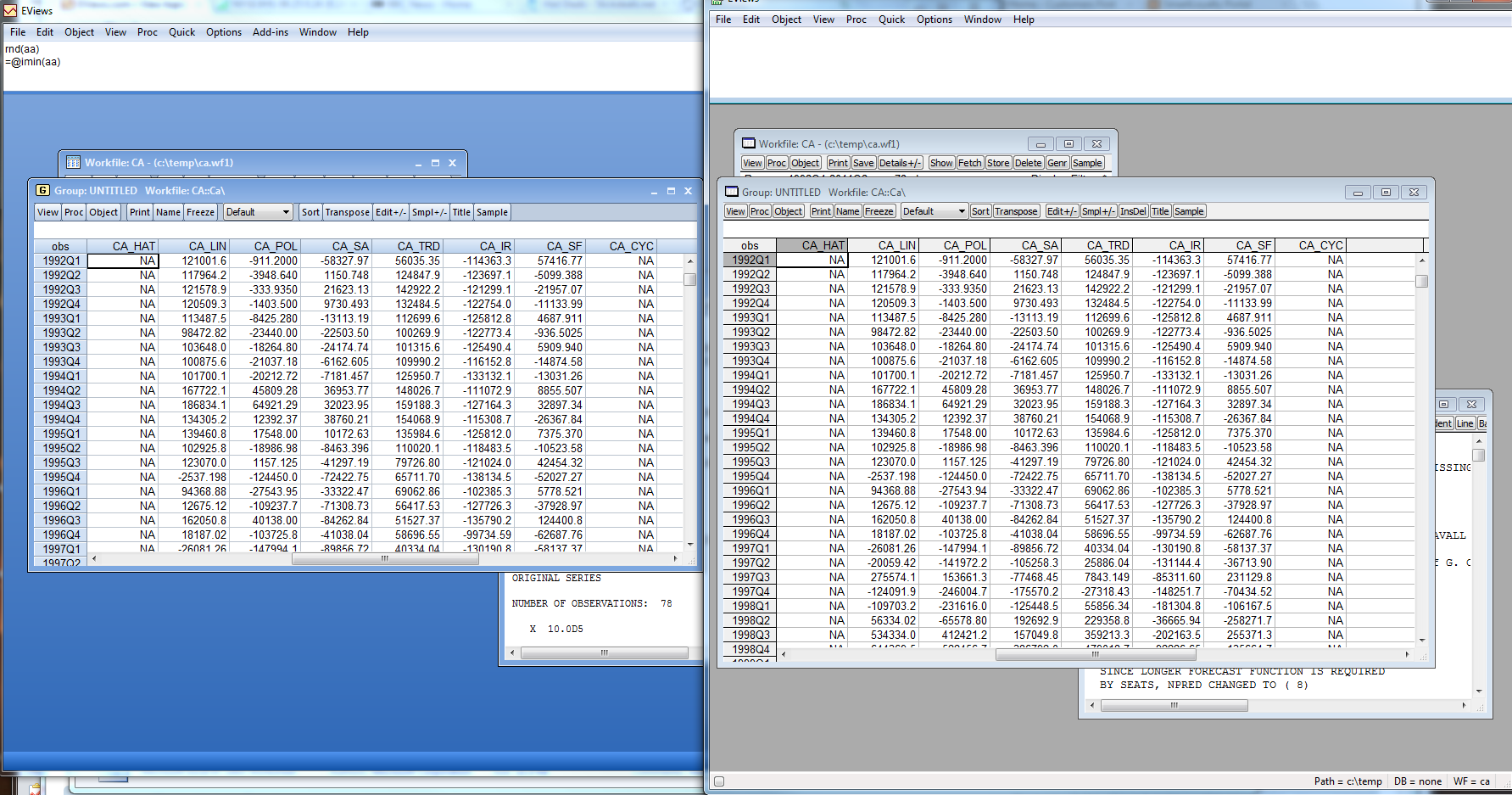

i seasonally adjusted my series both v5.1 and 7.1 and i got different results. for example v5.1 made my the first two observation positive(+) although in v7.1 they stayed negative(-). is there anybody have this problem.

i have eviews v5.1 and v7.1. i want to seasonal adjust my series. i import current account deficts series both v5.1 and v7.1... first i seasonally adjusted my current account deficit series with v5.1... v5.1 made my first two observations of current account deficit positive (+) although they are negative.. second i seasonally adjusted my current account deficit series with v7.1 because i want to compare v5.1 and v7.1.... v7.1 did not change my my first two observations sign.
i mean v5.1 and v7.1 give different results.(Tramo-Seats)

ok.please seasonally adjust my ca series using TRAMA/SEATS with eviews v5.1 and then v7.1. their seasonaly adjusment results different.

Identical.
