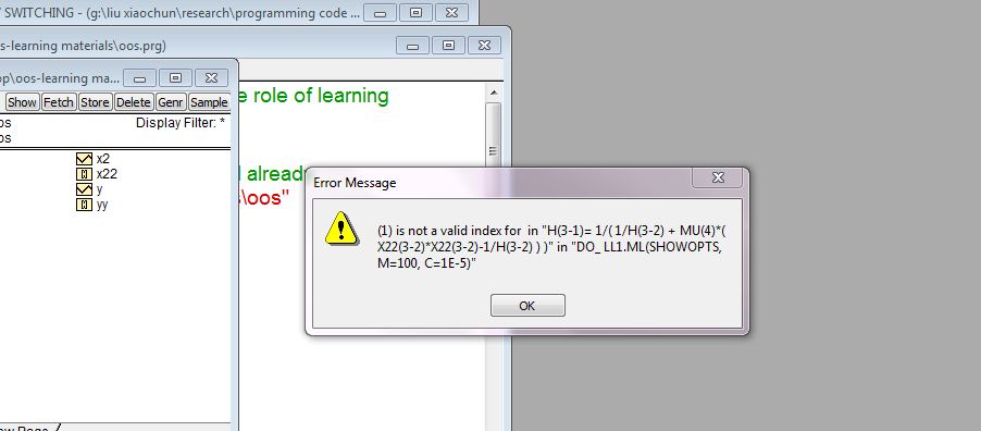

Recently I am trying to programming a Kalman filter in Eviews 6.0. In this programming, I use matrix and vector operation in logl for likelihood function. However, when I am running it, it always report some errors regarding the matrix and vector as in the following picture. I am wondering if anyone could tell if matrix or vector actually can be used in logl or not. Sometimes I think we only could use series in logl, right??? If this is true, that's really inconvenience. I really appreciate anyone help.
error in programming
The following is my Eviews code

Postby EViews Gareth » Sun Oct 17, 2010 9:29 am
Matrix objects cannot be used inside a LogL.

Is there any way to work out this matrix loop? something like writing a function or subroutine, then call the subroutine from logl.............
Re: a programming error for matrix in logl
Postby EViews Gareth » Mon Oct 18, 2010 10:59 am
LogL objects exist outside of the programming language, so you can not use any programming language constructs (loops, subroutines etc...) inside them.

Is there a way to not use matrix in my code for logl? I cannot figure out how to do my code if I do not use loops or matrix? Thanks
