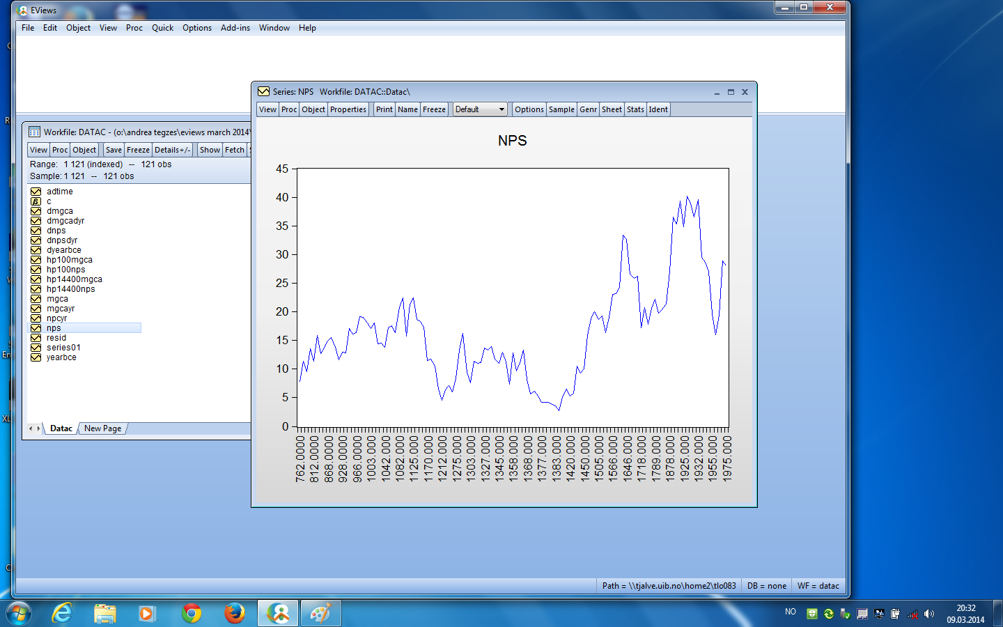

Mysterious --- I have attached a print-screen so you can see what I see. (I selected and opened the variabel PNS, then selected Graph)

Postby EViews Gareth » Sun Mar 09, 2014 3:11 pm
Ah, I had assumed you were doing a scatter graph.
Open up the Adtime series, hit Properties, then change the display format. Then recreate your graph.

Postby Pantera » Sun Mar 09, 2014 3:22 pm
Thank Gareth - you solve the problem!
