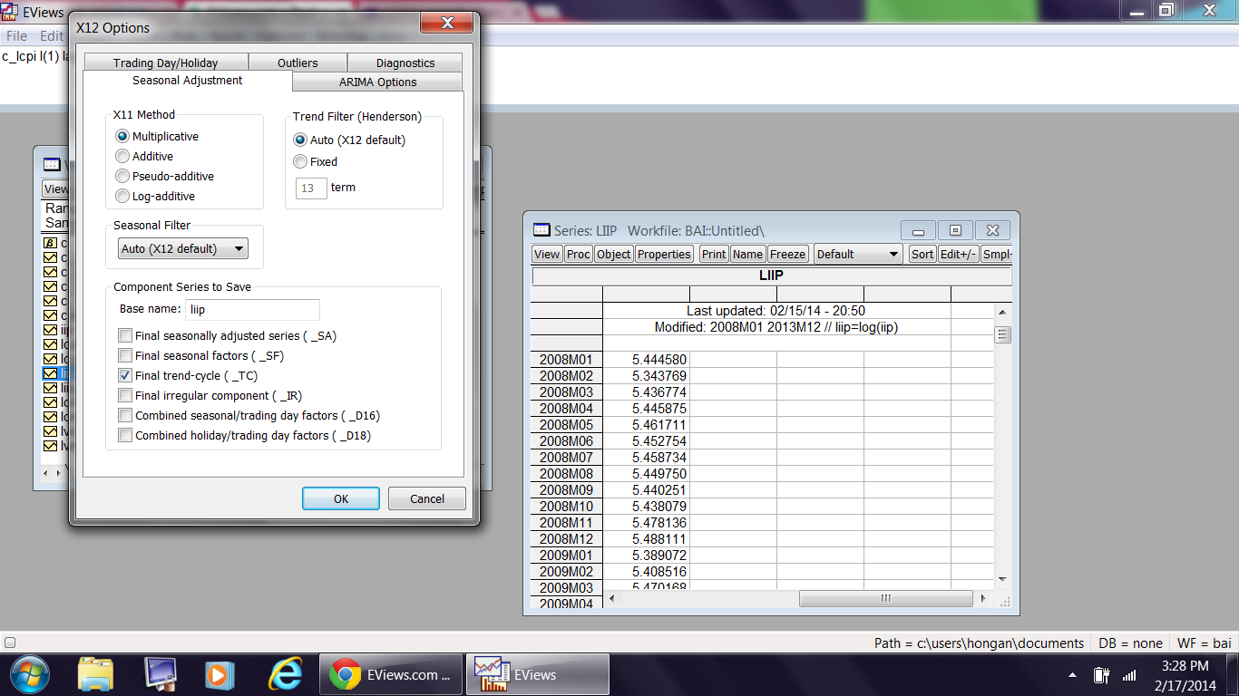

Hi! I'm a new user and I have some questions about Seasonal adjustment.
I am using X-12 on Eviews 6.0 to extract and get the trend-cycle data from the original series. Could anybody show me the differences between the two following output options: (1) Final seasonally adjusted series and (3) Final trend cycle?
If I want to get the trend-cycle data from the series, is it true when I choose the option "Final trend cycle"?
The image was attached below. Thank you!

Postby ChockalingamKC » Thu Feb 27, 2014 8:05 am
Final seasonally adj series - has the trend and irregular component
if you want just the trend, model Final trend
