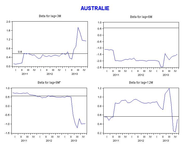

I would like to add specific lines to multiple graphs using the command DRAW (or something else you might suggest).
Here is the image of my graph :
Here is the code I'm using :
beta1.displayname Beta for lag=3M beta2.displayname Beta for lag=6M beta3.displayname Beta for lag=9M" beta4.displayname Beta for lag=12M freeze(beta_au) temp.line(m) beta_au.addtext(t,textcolor(blue),font("arial", 20,+b)) "AUSTRALIE" scalar mbeta1 = @mean(beta1) beta_au.draw(line, left) mbeta1 show beta_au
I got 2 questions :
1) How can I add specific lines to each graph in the figure ? For instance, the horizontal lines you can see in all graphs is the mean of "beta for lag 3". The command "beta_au.draw(line, left) mbeta1" is adding the mean of beta1 to all graphs whereas I would like to have each graph with its own mean.
2) How can I add a text to each horizontal line ? I added the "0.6" you see in the first graph manually.
Thanks for your help,
Mara
Re: Adding specific lines to multiple graphs
Postby EViews Gareth » Thu Jan 09, 2014 9:00 am
On my phone, so can't check exactly, but the general rule of thumb is that you add text, formatting, lines, etc... to the individual graphs before merging them into a multi graphs
