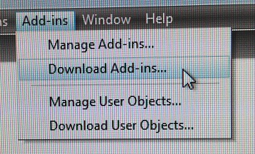

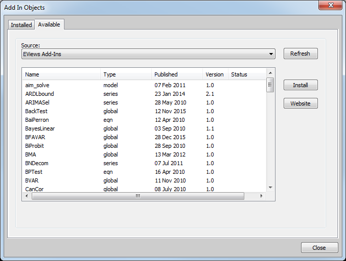

Simply run EViews, then go to the Add-ins menu and select "Download Add-ins".
Then select an add-in you wish to use and click the Install button.
