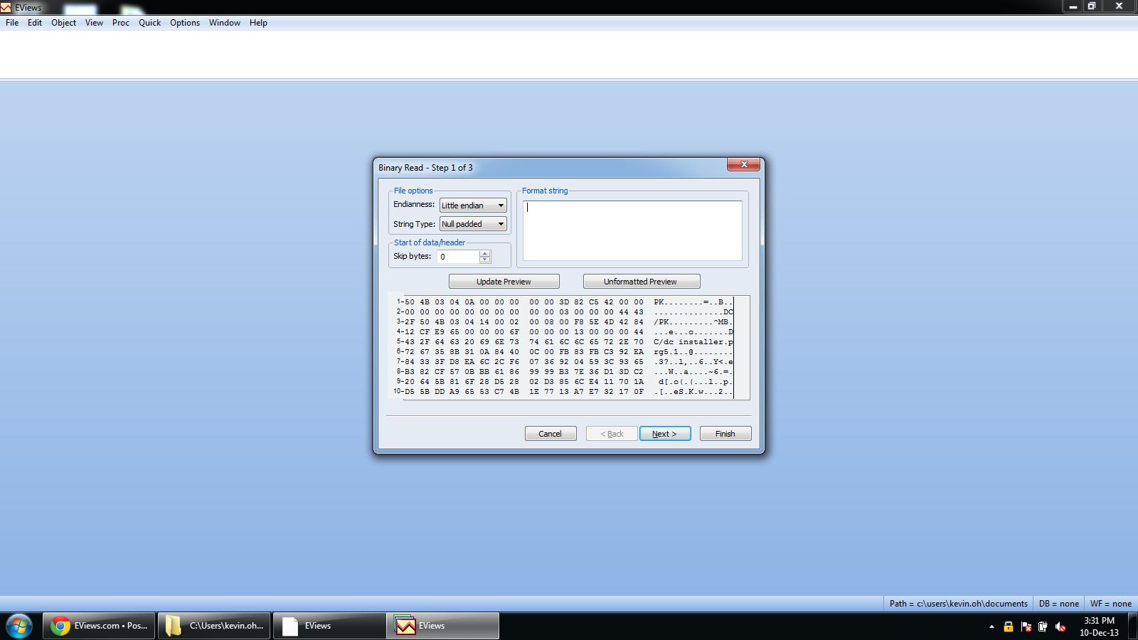

I'm using EViews 7 (Standard Edition - Mar 1 2010 build). Tried installing add-ins from the EViews add-ins page but received an error window that reads:
"Binary Read - Step 1 of 3
File options
Start of data/header
Format string
Update preview
Unformatted preview:
... followed by a preview of some characters.
Also, I don't have an Add-Ins tab in the main menu when I launch EViews.
Could someone advise please? Thanks.

- Image
- Add-in error.jpg (111.21 KiB) Viewed 81674 times

We have the .aipz files saved on our network. I have double-clicked on them, this opens up an instance of Eivews with the Binary Read dialog box pictured in the first post.

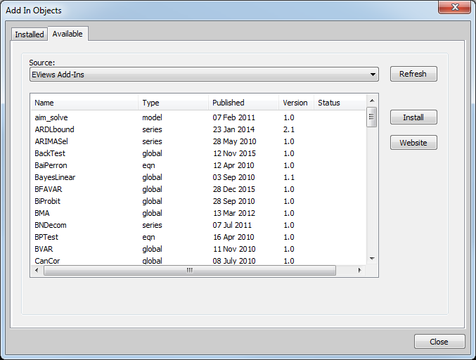

Re: Unable to install add-ins
Simply run EViews, then go to the Add-ins menu and select "Download Add-ins".
Then select an add-in you wish to use and click the Install button.
If you'd like to see more information about each add-in, visit our forum site here:
http://www.eviews.com/Addins/addins.shtml
