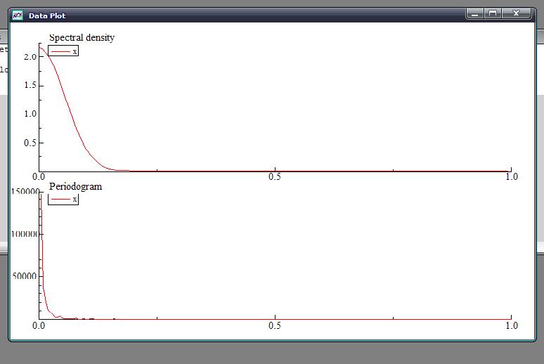

thank's for this add-in :D , just i have one suggestion if in next version of Periodogram (update version) can calculte spectral density and show the spectral density like oxmetrics software.
best regard.

I don’t know OxMetrics. But the Periodogram is the nonparametric estimator of the population spectrum, perhaps what is needed is the estimated periodogram with kernel (different windows, I'm working on it). I'm not sure if you were talking about this. I would appreciate if you send me papers or literature if not. Thanks. :D

thank's for your reply
yes I'm talking about the different windows
for OxMetrics 6 it will plot spectral density and periodogram in separate graphs for the serie it use probably Parzen windows (see the picture), the question is I can do periodogram and spectral density with defferent windows?

- spectral density and periodogram for OxMetrix 6
- dd-j.JPG (26.37 KiB) Viewed 37524 times
