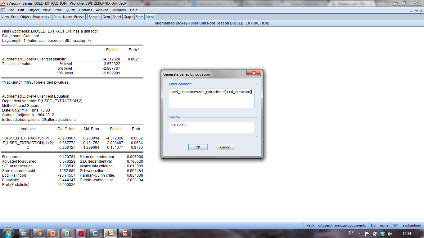

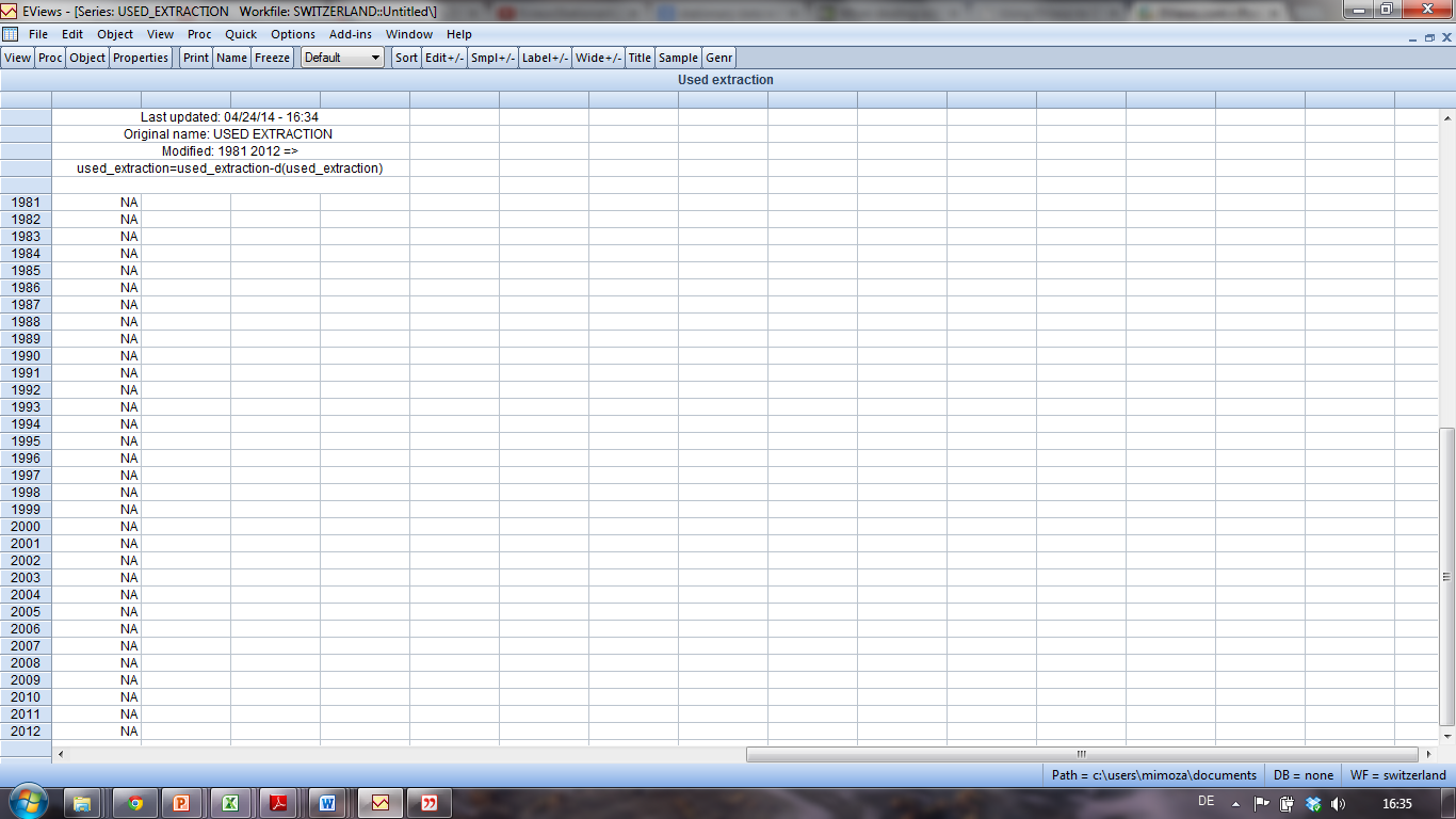

i am trying to learn how to use Eviews and along with it also statistics.
I am currently trying to convert the non-stationary data to stationary, but after i go through the process, then dhe result is the variable DY (new seriesm, of 1st difference) with NA values. What i am not getting is, why there are no values in the differenced variable?
Can anyone maybe help me here?

After Unit Root Test,i have to take the 1st difference to turn the data into stationary. After i get the 1st difference, i want to genr series by equation, and what i get is: :series: with NA values.
The same happens when i try to write down the genr equation on the top bar of the workfile, and try to pres enter so that the new genr series shows up in the workfile, but nothing happens. How can i save the new data of 1st or 2nd difference in my workfile?
The data i am using are normalized (index 1980=100). Do i maybe have to use absolute values instead?

- Posts: 3798
Re: non-stationary data to stationary
Try
Although I believe what you are computing is
which is probably not what you intend.
temp = d(used_extraction)
used_extraction = used_extraction - temp
used_extraction = used_extraction(-1)Re: non-stationary data to stationary

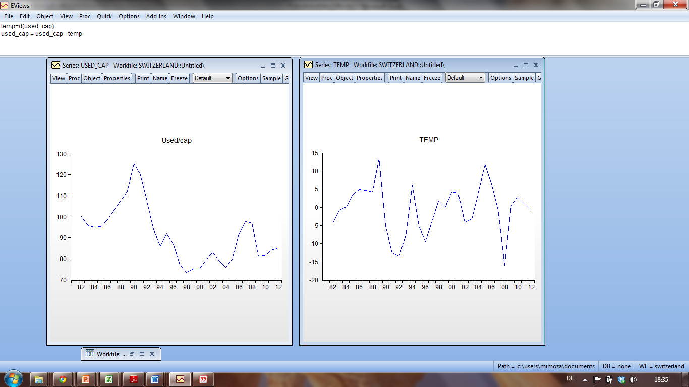

thank you so much startz.
Because i already lost the used extraction values (have only NA values now), i tried with another variable (used/cap) and the result i got is: check file attached.
Does this mean that i have to do the same for all my variables one by one, until i get the stationary versions, and then can continue with analysis and model development?

- Posts: 3798
I'm really not sure what you're trying to do, but if you want to first difference a variable X use
and then work with the variable firstDifferenceX without further adjustments.
series firstDifferenceX = D(X)
