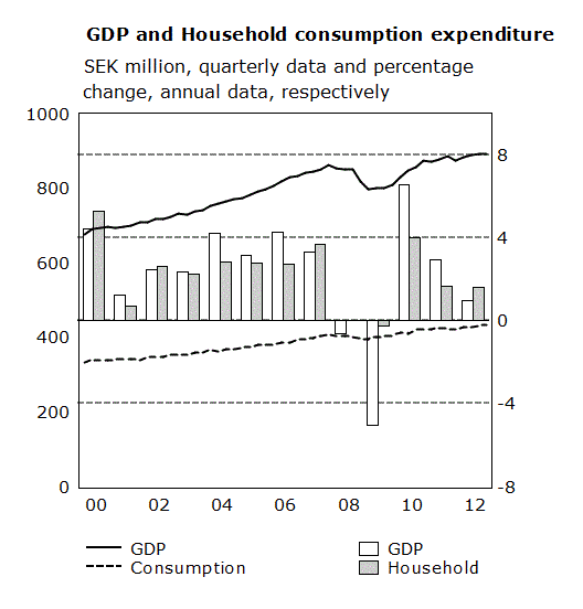

The National Institute of Economic Research in Sweden are currently in a process of replacing Aremos with Eviews as the agencies’ standard software for macro data handling, modeling, forecast production and graph production (see also mail from us 11 December 2012).
We have nearly manage to write an Add-In that handle the problem with mixing frequencies on the right and left hand axes and mixing lines and bars on the right and left hand axes. The technique we use is to place graphs on top on each other. What's remains is the possibility to controlling the number of gridlines, to get the same number of gridlines on the left and right hand axis.
An option like this would mean a great improvement for us.
See graph below that illustrate the problem with different number of gridlines.
