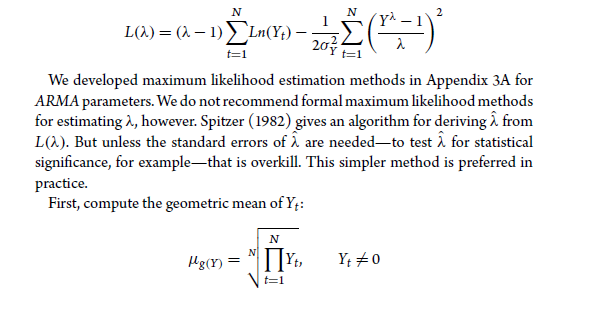

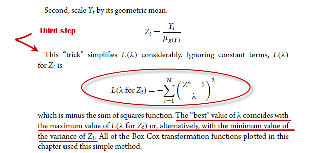

It's possible to estimate the best value of lamda Box-Cox transformation with "use Spitzer(1982) algorithm diriving from L(lamda)".
First, compute the geometric mean of Y(t), with Y(t)<>0.
Second, scale Yt by its geometric mean:
third, the “trick” simplifies L(λ) considerably. Ignoring constant terms, L(lamda)...
my question is: How can estimate the best lamda value with Spitzer(1982) algorithm or via simple program, honestly i have a difficulty to interpret the third step by LogL.
Could someone help me.
Best Cherif.
series gm=@gmean(Y)Code: Select all
series z=y/gmmy question is: How can estimate the best lamda value with Spitzer(1982) algorithm or via simple program, honestly i have a difficulty to interpret the third step by LogL.
Best Cherif.
