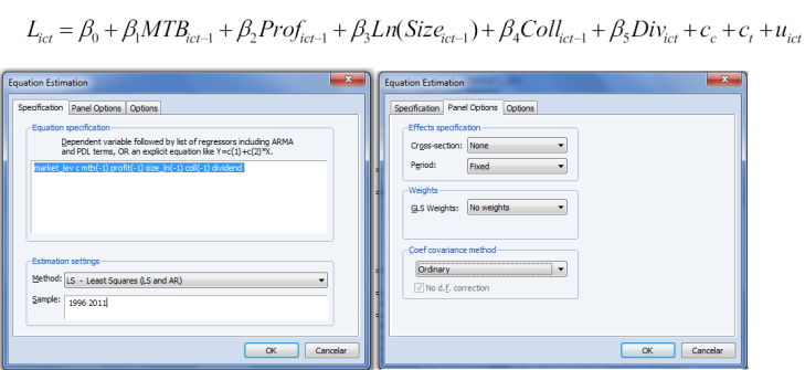

I'm working with a sample of the 100 largest publicly traded banks in Europe from 1996 to 2011 (a total of 1133 observations). Banks are from 25 diferent countries.
I'm using eviews to estimate a regression in which Leverage is the dependent variable and then I have 5 explanatory variables (one of them is a dummy - dividend payer). Please see attached the equation.
I'm using a dated panel data (annual freq, banks are the cross-section) and LS Method. I think is what best fits...
Q1:
Following the available literature in corporate finance I have to use time and country fixed effects (Ct and Cc). Regardind time fixed effects I found it easy (panel options / Effects specification / Period:Fixed).
Could you please give me some guidelines to deal with country fixed effects? (One of my available variables is country)
Q2:
what should I do to adjust the standard errors for clustering at the bank level (cross-section)? Should I use the white period coef covariance method in the panel options? Is it enough?
Q3:
variable Div is a dummy (1 if bank pays dividends in a given period, 0 otherwise). Once is a dummy it has the same processing and interpretation of remaining variables?
Many thanks in advance!

Q1:
Q2:
Q3:
zeca

Thanks for quickly reply and help!Q1. @expand(country, @dropfirst)
Q2. That does robust clustered standard errors. Whether it is enough of not, only you can say.
Q3. For almost all purposes, are the same as any other variable.
Q1: just to confirm, is it?
book_lev c mtb(-1) profit(-1) size_ln(-1) coll(-1) dividend @expand(country, @dropfirst)
Q2: I wanted to ask you if it would be necessary to choose a GLS Weights or if the standard errors adjustment for clustering at the cross-section level is done simply by using the white period coef covariance method?
Many thanks!!
- Posts: 2682
Re: fixed effects and clustering standard errors - dated pan
Q1. If I'm understanding what you are doing correctly, yes.
Q2. Whether to do GLS or have standard errors that are robust to departures is really a personal choice. The White period computes the standard errors clustered on cross-section ID.

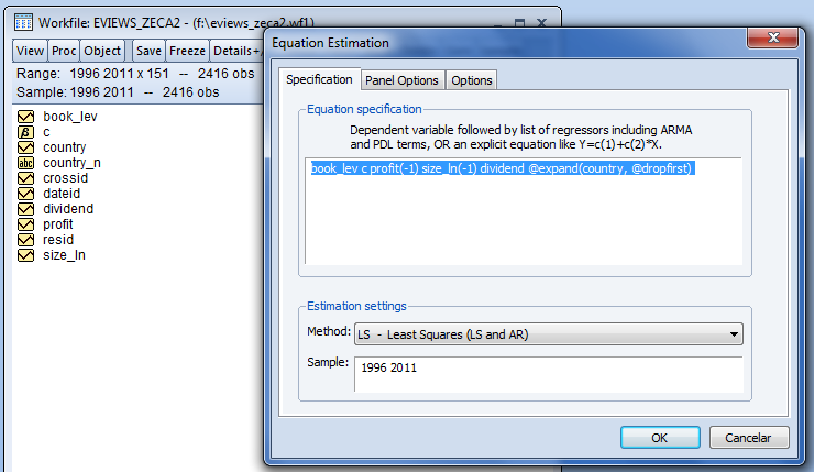

I'm back because against all my expectations, when I run this equation eviews give me the error "near singular matrix".Q1. @expand(country, @dropfirst)
book_lev c profit(-1) size_ln(-1) dividend @expand(country, @dropfirst)
There are any other way to take into account the country fixed effects in this case?
I'm sending attached the workfile. Could you please help me with this?

You're doing fixed effects on the crossid (banks?). Once you remove bank variation, there's no variation in the country. Another way of saying this is that your bankid and countryid variables are perfectly correlated.
In fact i´m not doing fixed effects on the crossid but on period. But even without consider any other fixed effect, the error msg appears.You're doing fixed effects on the crossid (banks?). Once you remove bank variation, there's no variation in the country. Another way of saying this is that your bankid and countryid variables are perfectly correlated.
you can test by yourself writing: book_lev c profit(-1) size_ln(-1) dividend @expand(country, @dropfirst) in the workfile I posted.
And i do not find evidence that bankid and countryid variables are perfectly correlated...
could you test please to confirm if it works with you?
thanks a lot

As to the latter..
show @varsby(country,crossid)
shows that there is no variation in the country indicator once I control for the cross-section ID. Another way of saying that is that banks don't change countries in your sample.
I assumed that you were doing cross-section effects. Let me look at the period effects issue.
[edit]
Looks as though there is simply multicollinearity between regressors. I'll leave it to you to find out why. But if you take the spec and estimate with the dummies and remove DIVIDEND, you get estimates...
[edit]

zeca,I'm back because against all my expectations, when I run this equation eviews give me the error "near singular matrix".
I get the same error as you in a very similar situation in my own panel data. I discovered that @expand(country) includes a dummy for every country in your database, even if some countries are excluded from the estimation sample. For example, if you set your sample to exclude banks from Germany (e.g. if country<>"Germany"), the dummy for Germany will still appear in your equation for the non-German observations in the form of a vector of zeros.
Alternatively, if you have missing values for several variables in your equation that result in the German observations being dropped from the estimation, you will also get a vector of zeros appearing in the place of the German dummy. Either way, a vector of zeros causes an error.
If this is your problem, you would need to create another version of the country variable that includes only the countries actually represented in the estimation sample. This new variable could then be used with @expand.
