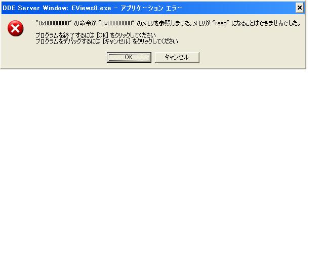

Thank you for the prompt reply. However, changing the option didn't solve the problem (Moreover, 'Open in new EViews session/window' was selected from the start). I'm attaching the jpeg image of error dialogue; sorry it's in Japanese - translation of the messages is as follows:
<Header> DDE Server Window: EViews8.exe - Application Error
The instruction at "0x00000000" referenced memory at "0x00000000". The memory could not be "read".
Click on OK to terminate the application
Click on CANCEL to debug the application
<Buttons>[OK] [Cancel]
BTW, this error doesn't occur at Eviews7.

- pageloaderror.JPG (24.47 KiB) Viewed 10368 times
