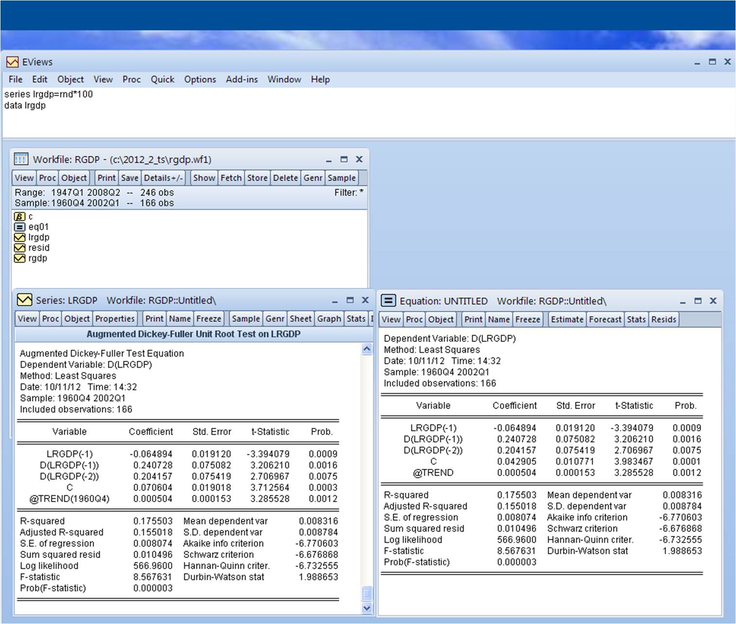

I'm using Eviews7, Gareth.
And you are right. I did the same thing you did. As you posted, they were perfect match.
Below is what I did. And I attached a screenshot.
The range of lrgdp data is from 1947q1 to 2008q2.
I set the sample period from 1960q4 to 2002q1.
1. Using built-in ADF test
Open 'lrgdp' and view-unitroot test-ADF(level, trend and intercept, lag length 2)
2. Estimating ADF test
Quick-Equation estimation
Set sample from 1960q4 2002q1
Specification: d(lrgdp) lrgdp(-1) d(lrgdp(-1)) d(lrgdp(-2)) c @trend
- Screentshot
- ADF.jpg (235.62 KiB) Viewed 2830 times
