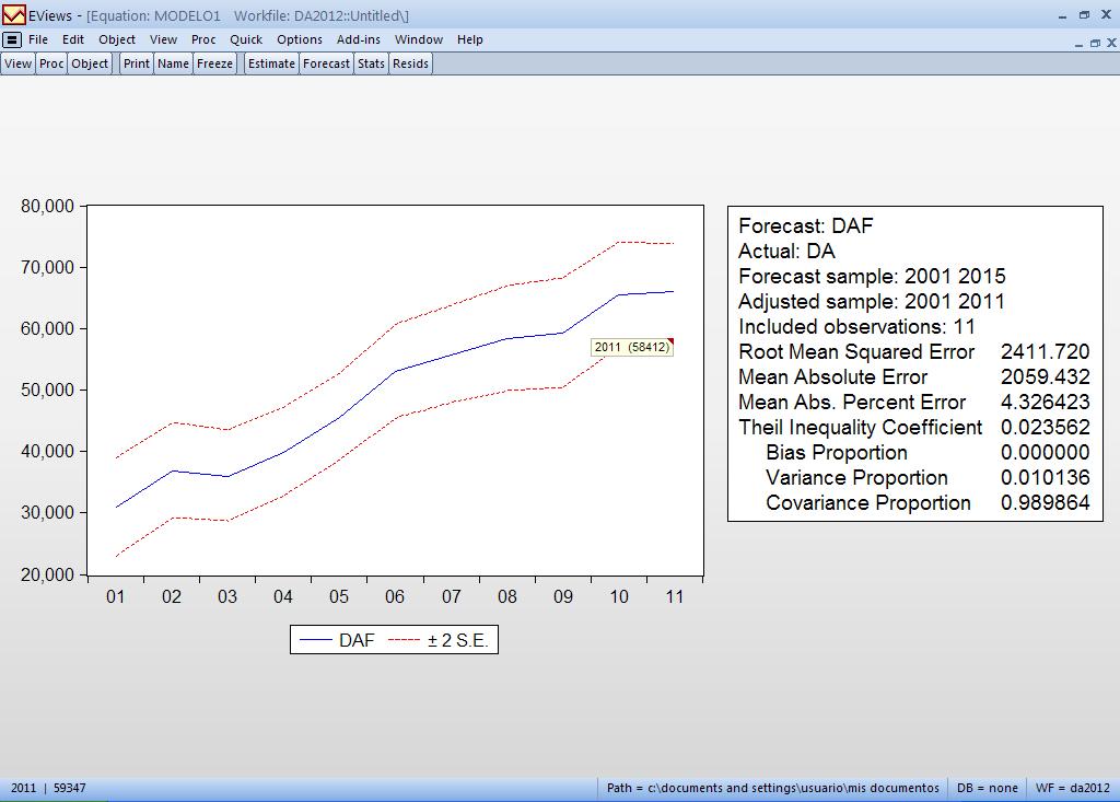

HEY PEOPLE
I NEED SOME HELP WITH THIS TOPIC
I RECENTLY DOING A WORKFILE WITH TIME SERIES AND A SMALL SAMPLE 2001 2011
MACRO VARIABLES, ANNUAL DATA
ALL OK (HETER.., AUTOCORR, RAMSEY TEST, ETC.) THEN WAS TO THE FORECASTING
FIRST, I ADJUST THE SAMPLE IN THE WORKFILE (PROC STRUCTURE/RESIZE...) 2001 2015
THEN I WENT TO THE FORECASTING AND ADJUST THE FORECAST SAMPLE 2001 2015
BUT THE OUTPUT WINDOW ONLY DISPLAY GRAPH UNTIL 2011 (ADJUSTED SAMPLE)
THEN I RUN THE FORECASTING AGAIN BUT ONLY FOR 2012 2015
AND PROMPT THE MESSAGE: "UNABLE TO COMPUTE DUE TO MISSING VALUES"
THE BOX FOR "INSERT THE ACTUALS FOR OUT-OF-SAMPLE OBSERVATIONS" WAS CHECKED PRVIOUSLY
SO WHAT HAPPEND??? !!!

THIS IS WHEN I TRY TO FORECAST 2011 2015

Do you have values for your independent variables for the forecast period?
That`s is my question. If i dont have any observation for the period of forecast -out of sample- then i can´t do the forecast?
My sample for example is: 2000-2011. With that i run the models etc. Then i want to forecast 2012-2014 for example but i dont have that observations because they are in the future. I can't do the forecast??? if the answer is yes, then for what work this?? i want to predict the future, not verify theoreticaly my data sample.
Could explain me some og this because now i am confusse.
Thank you!
Re: FORECAST OUT-OF-SAMPLE ....HELP!!!
Postby EViews Gareth » Sun Oct 28, 2012 12:43 pm
If you say that Y depends upon X, then to predict Y you need a value for X. Simple maths.
FASTONE
Posts: 6
Joined: Sun Sep 23, 2012 3:56 pm
Postby FASTONE » Sun Oct 28, 2012 1:44 pm
There is a way of automatically generate regressors to predict is achieved. Or the only predictions that can be made are short term ones
Postby EViews Gareth » Sun Oct 28, 2012 1:52 pm
No, EViews has no way to magically generate values for regressors. You have to define a model for them too.
