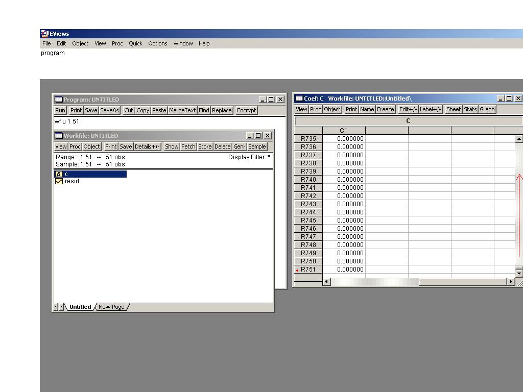

Thank you for your answer. I uploaded a file, really, I don't know how explain it, but for example: If you put in a text
"wf u 1 51"
I'll hope only see 51 "C", betas, constants, intercepts, etc... However I'm seeing 751 (R751) and not 51!
Regards!

When you create a workfile, you define the sample period that does not apply to vectors and matrices. Otherwise, you would not be able to make operations on matrices that have more observations than the sample size. "C" is a predefined (and reserved) coefficient vector of size 751 and gives you the flexibility of running/solving large scale equations/models without worrying about betas. If you ever need a larger coefficent vector, you can always explicitly define your own coefficient vector and use it in your calculations.

I don't understand the relation between "my problem" with the matrices. Not only if i write "wf u 1 51" i'll see the same problem, for example if i put File / New / Workfile / Unstructured - Undated -> Observations 51, there is the same problem; with all options (Dated-Regular -> Anual, Monthly, Weekly, etc.), again, there is the same problem, etc, etc.
Anyone know a solution? Maybe I changed a "configuration of default" (I don't remember) but I don't find nothing.

Why do you think you have a problem? C is not used for storing data.

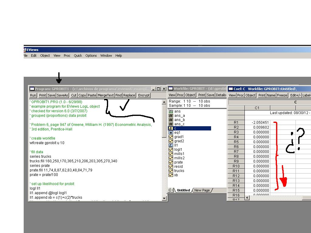

For example, in this post where I'm using the "Sample Programs" of Eviews 6. Its in "logl file" -> gprobit1.

All know which its ok, however, (how you can see the picture) the "Constant" (beta, c, any...) not "take up" the regression, and all seeing:
R1 -2.050451
R2 0.009602
R3 0.000000
R4 0.000000
R5 0.000000
R751 0.000000
Now, Can you understand me?

It is nothing to worry about. C is always exactly the same size in all workfiles.
