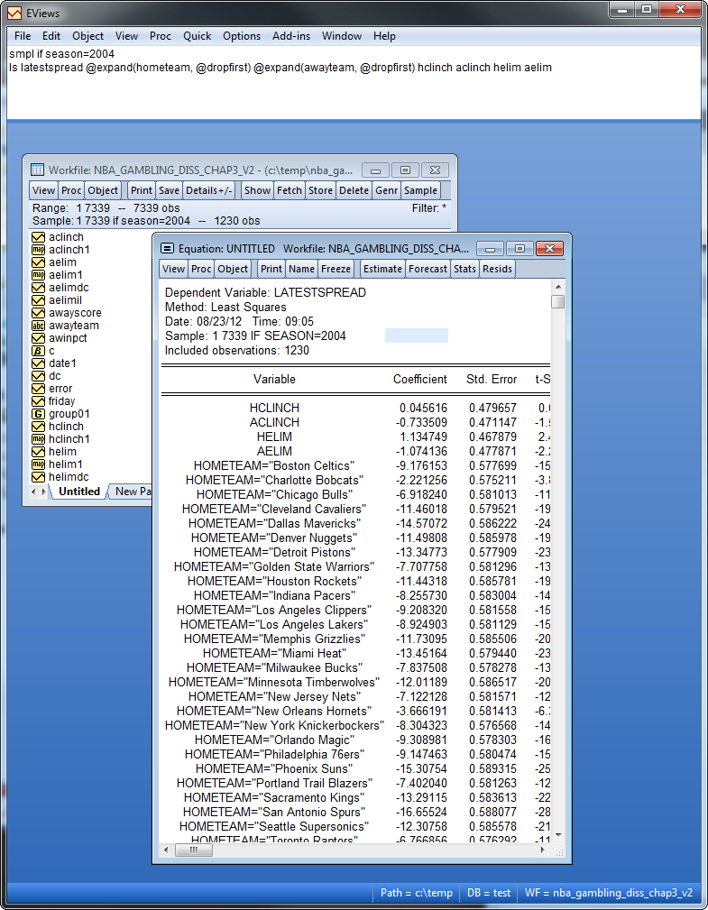

Before running SUR, I tried running each equation seperately with @expand and @dropfirst commands for both categorical variables (hometeam & awayteam), they both give me singular matrix errors. This is how I wrote out each equation:
ls latestspread @expand(hometeam, @dropfirst) @expand(awayteam, @dropfirst) hclinch aclinch helim aelim
ls pointdiff @expand(hometeam, @dropfirst) @expand(awayteam, @dropfirst) hclinch aclinch helim aelim
Do you know what might be causing this problem?

Postby EViews Gareth » Thu Aug 23, 2012 9:06 am
Worked for me:

Postby rontwfs » Thu Aug 23, 2012 8:42 pm
Wow it was that simple ... Thank you so very much Gareth.
