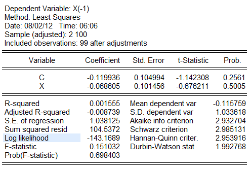

I did the the following test.
create u 100 series x=nrnd ls x c x(-1) ls x(-1) c x
Unlike the OP, I got an F-stat. However, note that I got different R^2, which is wrong unless it's round-off error.

In the first you're regressing X on its future value, in the second you're regressing X on its past value.
Different estimations.
Perhaps you meant an example such as:
create u 100 series x=nrnd ls x c x(1) ls x(-1) c x
Which also gives different R^2. That's because the sample is different.

Gareth,
I don't think so.Both equation windows show the same sample.
And in a bivariate regression the R^2 should be the same whether you regress y on x or x on y. (The square of the correlation coefficient.)
Perhaps this is an issue of exactly how the R^2 is calculated, since the means of the dependent variables will be slightly different?

There is something strange but I'm not sure what it might be. If I had to bet I think it's the fact that the descriptive statistics aren't computing the lagged dependent properly. I'll look into it.
