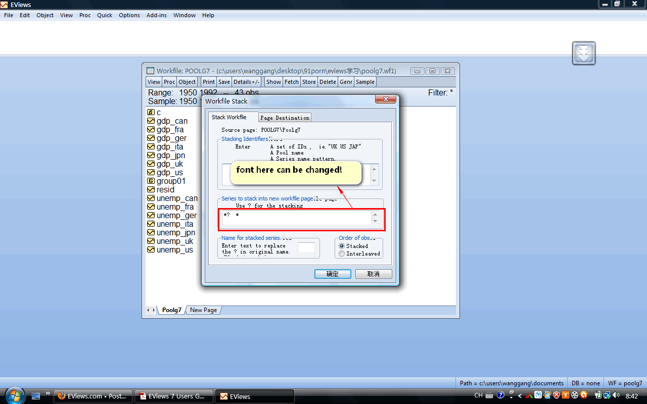

After installing eviews7 in my computer,vista OS,I find many dialog boxes are unable to display the contents completely,these can be seen from attachment.
these problems make me headache.Anybody can guide me to through it?

Looks like you have a weird system dialog font or something.
Do you have a foreign language version of Windows?
Re: about display of content in dialog box
yes,my operation system is simplified Chinese version!

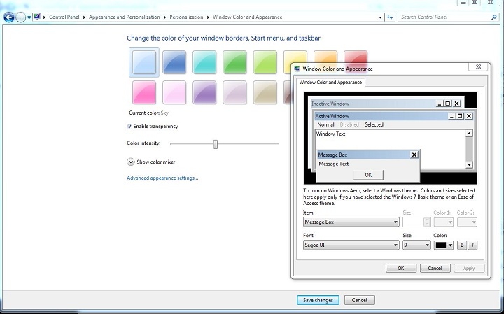

Try starting Control Panel and then choosing Appearance and Personalization\Personalization\Window Color and Appearance. Next select Advanced appearance settings. You should see something similar to
Next click "Message Text" in the Window Color and Appearance dialog. Now try changing the "Font:" as well as the size.
hi,Jason: thank you for your advise,however,after trying it, i found the problem still exist. Modifying the font from message box just change the content of message box, the others content cannot be changed ,you can check the attachments!

I was hoping you could change the fonts without having to edit the registry, but apparently we cannot avoid it. As a general note, modifying the registry is potentially very dangerous, so be careful.
First you will need to start the registry editor. Press the Windows button in the lower left of your screen and then type regedit in the 'search programs and files' box. regedit.exe should be returned as a result. Click regedit.exe to start the registry editor.
From within the registry editor, navigate to:
HKEY_LOCAL_MACHINE\SOFTWARE\Microsoft\Windows NT\CurrentVersion\FontSubstitutes
In the right pane, you should something similar to .
Write down your current settings for MS Shell Dlg and MS Shell Dlg 2. In my case, they are Microsoft Sans Serif and Tahoma. Change those values to more appropriate fonts.
See 'Option Two' http://www.sevenforums.com/tutorials/11 ... hange.html for more detailed instructions.
Note: you will need to log off and log back in for the changes to take effect.
