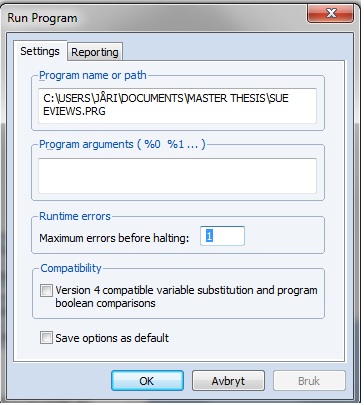

Posted: Thu Jul 26, 2012 2:25 am
by martingale
Program halts EViews.jpg (49.83 KiB) Viewed 14832 times
The program halts at the first series "sue_n_fro_eps_" where the error message is generated. A solution is to increase maximum errors before halting but it might ignore sources of other types of errors. A better solution is to program a subistitution of 0's with "NA". How could this be done?

Posted: Thu Jul 26, 2012 11:09 am
by EViews Glenn
By stop, I meant within the one series generation. You are correct that after that series is generated, the program will stop.
I note that your proposed solution modifies the original series which generally makes me nervous.
Moreover, I don't think this modification is really what you want to do. You are replacing all values where the series equals zero with NAs, otherwise you are including the negative of the original series. Apart from the negative part, which I think is just a mistake, that substitution will solve the problem, but will also modify your @MOVSTDEV results everywhere there is a data 0 in the span, even if the original @MOVSTEDEV result is nonzero. What I think you want to do is to replace the 0's in the resulting moving standard deviation series:
For !i =1 to OBXEPS12AAR.@count %name = obxeps12aar.@seriesname(!i) series stdevtmp = @MOVSTDEV({%name},4) stdevtmp = @recode(stdevtmp=0, NA, stdevtemp) %newname = "SUE_" + %name series {%newname}=({%name}-{%name}(-4))/stdevtemp delete stdevtemp next
