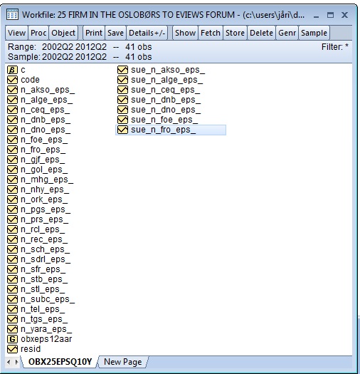

hi and thanx a lot, when I run the program I get the message "!i is not defined" (I uploaded the file in case)
- 25 firm in the oslobørs to EViews forum.WF1
- (25.08 KiB) Downloaded 538 times

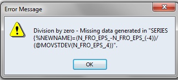

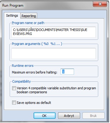

The program halts at the first series "sue_n_fro_eps_" where the error message is generated. A solution is to increase maximum errors before halting but it might ignore sources of other types of errors. A better solution is to program a subistitution of 0's with "NA". How could this be done?
- Series generation halts EViews.jpg (90.57 KiB) Viewed 14814 times
- Division by zero EViews.jpg (21.9 KiB) Viewed 14814 times

By stop, I meant within the one series generation. You are correct that after that series is generated, the program will stop.
