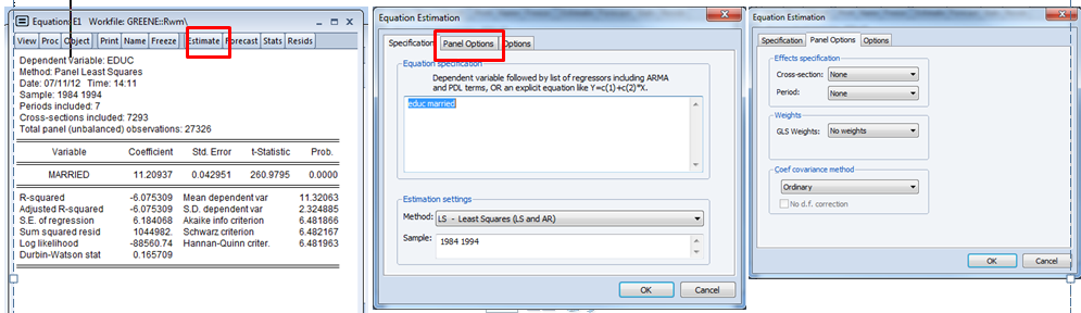

Do you know where I can select the option year fixed effects and industry and year fixed effects?Thank you!
Re: panel data and dummies
Postby EViews Gareth » Wed Jul 11, 2012 10:55 am
On the Panel Options tab of the estimate dialog. User Guide II has more details.

it refers to an option pool estimation but i can not find it. If you know, let me know.
Thank you very much for the help!!
EViews Esther
Posts: 149
Postby EViews Esther » Wed Jul 11, 2012 2:18 pm
