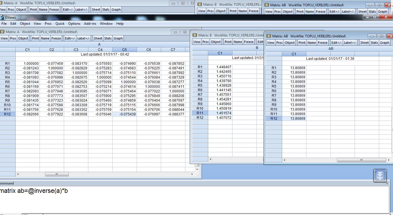

I have a matrix(12,12) A and a vector(12) B. When I declare a vector AB=@inverse(A)*B, I get very unreasonable result that all elements of AB same but must be different. Does anyone has any explanation for that?

Re: matrix multiplication
Most likely just a facet of your data.
In general, of course, that will not be the case:
create u 10
matrix(12,12) a
rnd(a)
a=a*a
vector(12) b
rnd(b)
show a
show b
vector ab=@inverse(a)*b
show ab
Your are right Gareth. Facet of my data.
