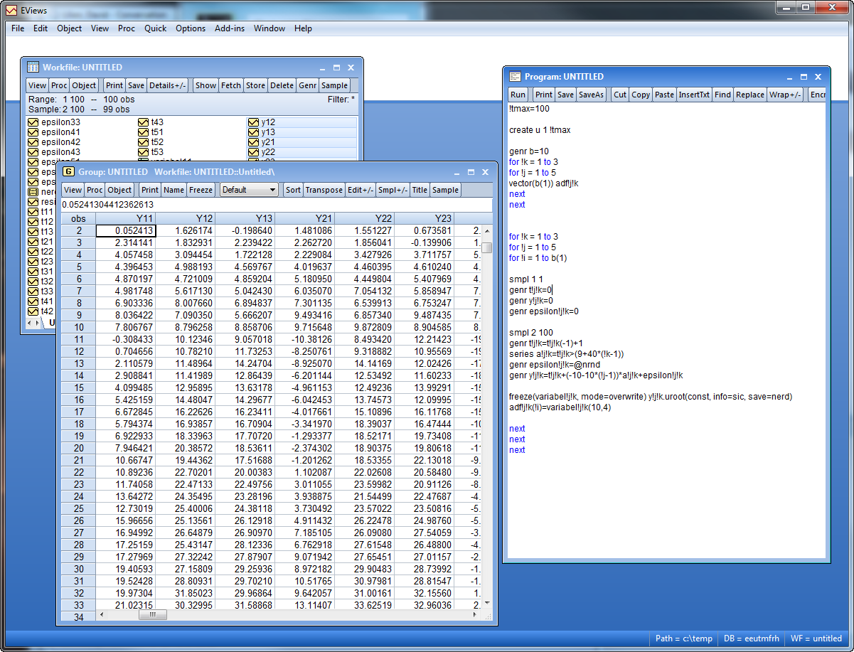

The only problem I can see with your code is that you're not using the overwrite option in the freeze command. If I add the overwrite command, things appear to be ok, from my perspective:
freeze(variabel!j!k, mode=overwrite) y!j!k.uroot(const, info=sic, save=nerd)
Re: Series not filled with values after loop
Please excuse my constat questioning, but do the resulting e.g. y11, y12, ... are filled with numbers or "NA"s when u run the code? Cause when i run it, all the resulting series, vectores, ... are only filled with "NA"s, which is my problem... :)
Thank you a thousend times for all the help yet.
Mig
Mig
Yep, filled with numbers.
- works.png (145.04 KiB) Viewed 5486 times
Hmmm.... I use EViews 7 and i get only NA's. Do you have an idea why?
What's the build date of your copy (help->about eviews)?
OK, I'm really sorry, i just rebooted my computer and now i get numbers, prob i should update my EViews :). But Prob it works now because of the overwrite, so still thank you veryvery much.
