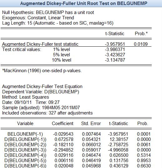

Having said that, I think if you include a time trend in your ADF test you'll reject a unit root for unemployment.

If I'm following what you did, you haven't got it quite right. You want to test for a unit root in levels. This gets rejected for unemployment in Belgium if you include a time trend. The strong implication is that unemployment is I(0). (A test for unit root in first differences is a test of the null I(2) against the alternative I(1).)

The ADF has the null that there is a unit root. If the ADF statistic is low then you don't reject the unit root. But myquick test (very quick test!) shows that the unit root is rejected.
