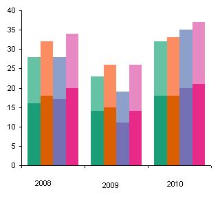

I have attached a sample picture of the chart which I have in mind. It could also contain 2 stacked bars per year (not necessarily 4, but it must be more than 1).

please find four sample time series in the attachment,
the series are named with the colors so that they correspond to the illustration of the chart which I have sent before (let's make the things simpler and ignore purple and pink bars)

Having spent some time playing with all the tricks I can think of, I think I've come to the conclusion that it is impossible.

Creating exactly the same graph as the original poster did, is not possible still, I think. EViews 9 did add support for mixed graphs with stacked bars though.
