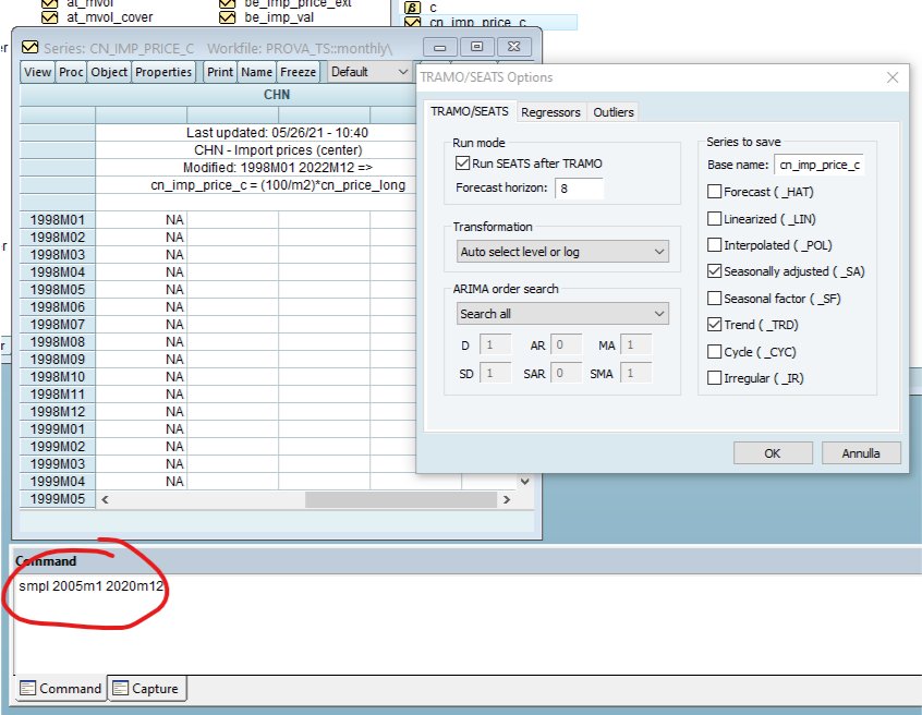

lbenci
Posts: 9
Joined: Fri Mar 23, 2018 8:17 am
Re: Seasonal Adjustment Error: "TRAMO/seats.itr not found"
Postby lbenci » Thu May 27, 2021 3:06 am
You can find the procedure in the three screenshot attached.
Fig11: I open the series, cut the sample in order to eliminate NAN, produce TS from the proc menu
Fig12: the procedure works properly (WF and output file will be attached in the next post); TS makes some adjustments (number of the predicted periods or outlier adjustments); command syntax is taken from the capture window, copied and pasted in the command window
Fig13: I have erased the series outcome of the previous adjustment to make sure they will not conflict with the new procedure; as told, the command is pasted in the command window (I did not include the correction on the command line but I can assure you that even if I did, this does not change the outcome); you can see the output, rather unexpected.
Next post, WF and TS output log (the one that worked).
Thanks for your help.
Postby EViews Gareth » Thu May 27, 2021 7:50 am
Yep, looks like command capture isn't working quite right.
cn_imp_price_c.tramoseats(save="sa trd") cn_imp_price_c
