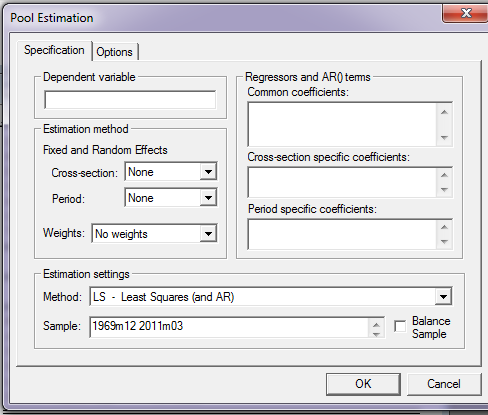

This topic relates to one of my previous posts not long ago http://forums.eviews.com/viewtopic.php?f=4&t=3916, in the previous post I was estimating the model using a simple country-by-country approach. I was able to modify the regression estimation quite easily by typing the modified equation (such as above model) into the equation specification section. But when I switched to pooled regression after realising the ignored cross-sectional correlations, I couldn't modify the equation specification anymore as pool estimation window dosen't support any customizations. (see attached)
By modification or customization, I mean estimate a non-standard econometric model (e.g above model), not a standard Y=c1+c2*x+c3*z+e model where the regression coefs are always next to the regressor.

Pooled Regression Estimation Window

As you point out, pooled regression does not let you estimate non-linear regressions, so you're out of luck.
You could, however, estimate it in a panel workfile. Although there is nothing built in to estimate c(1) as cross-country specific, you could use a dummy variable approach to manually estimate it.
