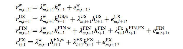

ramadhan23
Posts: 7
Joined: Wed Oct 15, 2014 5:46 pm
Re: instrumental variable help
Postby ramadhan23 » Tue Nov 04, 2014 10:54 pm
Screen Shot 2014-10-16 at 7.50.26 AM.png (29.32 KiB) Viewed 6876 times
Screen Shot 2014-10-28 at 7.34.17 AM.png (38.38 KiB) Viewed 6876 times
i want to ask how to use instrument variables into a model? i am working on a thesis about international capm and need to incorporate instrument variables to the estimation model as attached. as you can see the lambda m is the instrument variables, In my research i use 5 instrument variables (constant included) , can anybody explain how its done in eviews? thanks
