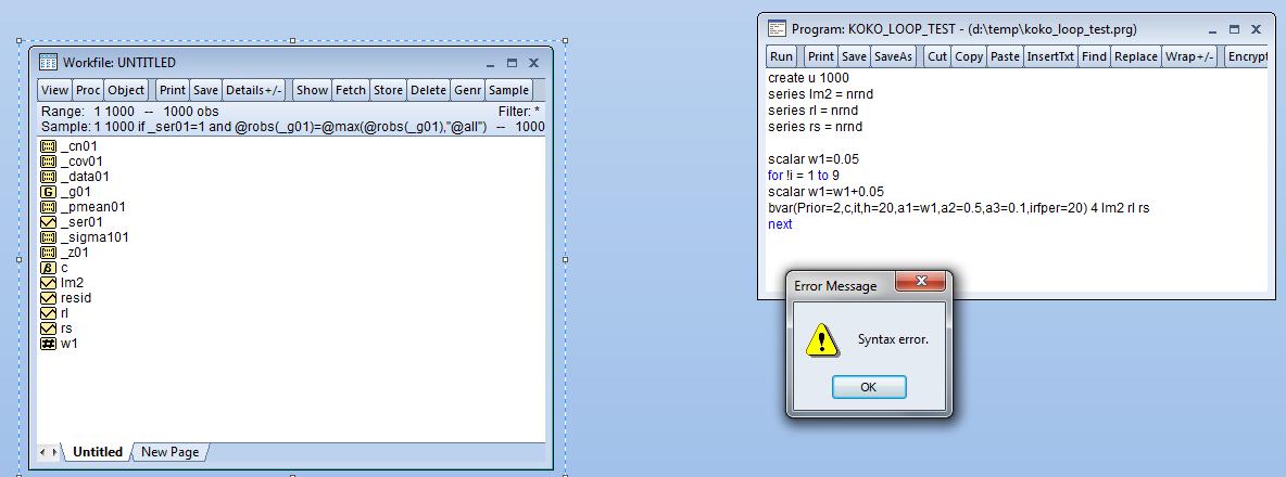

I downloaded and installed the new version of BVAR and also updated my EViews7.1 copy to build of Mar 15 2011, but when I ran Gareth's test programme, I obtained the results appended below. Perhaps the syntax has changed?
Regards
Donihue
Re: Koop-Korobilis Priors in BVAR
Posted: Tue Mar 29, 2011 8:12 am
by EViews Esther
Since "a1" is a string (e.g. %a1 = "0.5") just as other hyperparameters ("a2"and "a3") in the command options, we cannot assign a scalar value (bad e.g. %a1 = 0.5).
The problem can be resolved by changing "w1" into a "scalar (e.g. 0.5)" value.
[E.G.]
bvar(prior=2,c,it,h=20,a1=0.5,a2=0.5,a3=0.1,irfper=20) 4 lm2 rl rs
