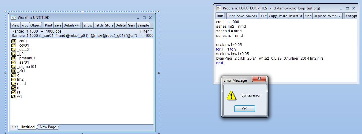

I downloaded and installed the new version of BVAR and also updated my EViews7.1 copy to build of Mar 15 2011, but when I ran Gareth's test programme, I obtained the results appended below. Perhaps the syntax has changed?

Postby EViews Esther » Tue Mar 29, 2011 8:12 am
Since "a1" is a string (e.g. %a1 = "0.5") just as other hyperparameters ("a2"and "a3") in the command options, we cannot assign a scalar value (bad e.g. %a1 = 0.5).
The problem can be resolved by changing "w1" into a "scalar (e.g. 0.5)" value.
[E.G.]
bvar(prior=2,c,it,h=20,a1=0.5,a2=0.5,a3=0.1,irfper=20) 4 lm2 rl rs

Thanks, Esther, for your clarification.
You are quite right, but that also seems to defeat the possibility of looping over values of, say, w1, as in Gareth's example, unless I have misunderstood.
That was something I was hoping to be able to do, and seemed to be possible before the latest change (although of course the looping did not then pick up the changes in the parameter ...)
Do you see any possibility of such loops? Is there a way to input loops of the necessary strings, for example? [Sorry - perhaps that question should be addressed to someone else?]
Regards
Donihue
Re: Koop-Korobilis Priors in BVAR
Postby EViews Gareth » Tue Mar 29, 2011 10:45 am
%w1 = @str(w1)
