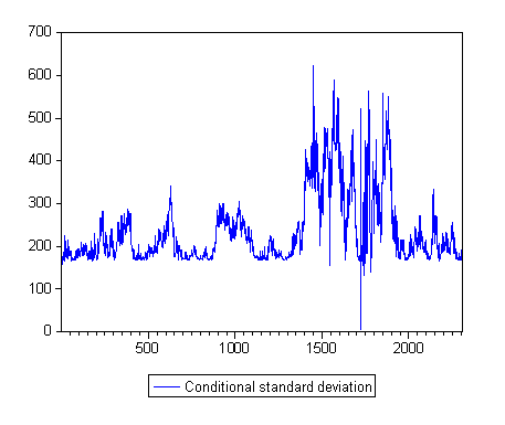

Can someone tell me exactly how I can interpret the Standard Deviation output from a GARCH model (attached)?
Is that an annualized Standard Deviaition? Also, is there a way to get the output in a table?

It is just the square root of the GARCH variance. You can get the GARCH variance by Proc->Make GARCH Variance Series.
