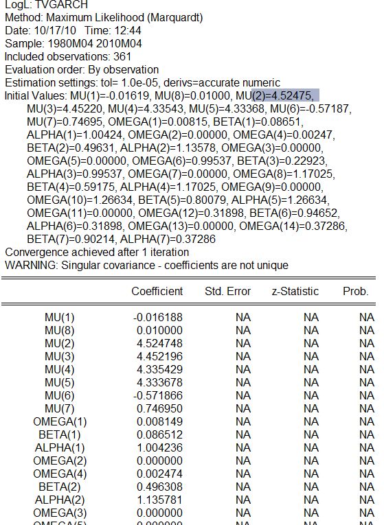

However, the discussion is about bi/trivariate GARCH. In these cases, we could spread out the var-covariance matrix to compute the matrix determinant easily. When the variables are going to be large, saying 7 variables in my cases, I think it's better to use matrix operation to @det(X) for determinants and others like a matrix multiplying a group.
Thus, I have modified the TV_GARCH example. But the results I got are not correct as following. Also, I have my code below. appreciate anyone help.
error infor
Here is my code. I suspect whether the matrix operation is incorrect. I appreciate anyone's help.

matrix mat_var7=group_var7
matrix mat_res=group_res
!m1=@rows(mat_var1)
!m2=@columns(mat_var1)
matrix(!m2,!m2) mat_var
rowvector(!m2) vect_var1
rowvector(!m2) vect_var2
rowvector(!m2) vect_var3
rowvector(!m2) vect_var4
rowvector(!m2) vect_var5
rowvector(!m2) vect_var6
rowvector(!m2) vect_var7
rowvector(!m2) vect_res
vector(!m1) vect_h
vector(!m1) deth
for !i=1 to !m1
matrix mat_varr=mat_var
vect_var1=@rowextract(mat_var1,!i)
vect_var2=@rowextract(mat_var2,!i)
vect_var3=@rowextract(mat_var3,!i)
vect_var4=@rowextract(mat_var4,!i)
vect_var5=@rowextract(mat_var5,!i)
vect_var6=@rowextract(mat_var6,!i)
vect_var7=@rowextract(mat_var7,!i)
vect_res =@rowextract(mat_res,!i)
rowplace(mat_var,vect_var1,1)
rowplace(mat_var,vect_var2,2)
rowplace(mat_var,vect_var3,3)
rowplace(mat_var,vect_var4,4)
rowplace(mat_var,vect_var5,5)
rowplace(mat_var,vect_var6,6)
rowplace(mat_var,vect_var7,7)
vector(1) my=vect_res*@inverse(mat_var)*@transpose(vect_res)
vect_h(!i)=my(1)
deth(!i)=@det(mat_var)
next
mtos(vect_h, s_h)
mtos(deth, s_deth)
' log-likelihood series
'tvgarch.append logl = -0.5*(!mlog2pi + s_h+ log(mu(8)) )
tvgarch.append logl = log(@dnorm(@sqrt(s_h)))-log(@abs(s_deth))/2
' remove some of the intermediary series
'tvgarch.append @temp invh1 invh2 invh3 invh4 invh5 invh6 sqres1 sqres2 sqres3 res1res2 res1res3 res2res3 deth
' estimate the model
smpl s1
tvgarch.ml(showopts, m=500, c=1e-5)
' change below to display different output
show tvgarch.output
graph var.line var_y1 var_y2 var_y3 var_y4 var_y5 var_y6 var_y7
graph cov.line cov_y1y2 cov_y1y3 cov_y1y4 cov_y1y5 cov_y1y6 cov_y1y7 cov_y2y3 cov_y2y4 cov_y2y5 cov_y2y6 cov_y2y7 cov_y3y4 cov_y3y5 cov_y3y6 cov_y3y7 cov_y4y5 cov_y4y6 cov_y4y7 cov_y5y6 cov_y5y7 cov_y6y7
show var
show cov

sorry, I forgot to say I only add one variance (var_y1) into this 7 variable GARCH-mean model as a test purpose.

There are several problems with your code, but the most crucial one concerns the likelihood function. Since the matrix operations are not allowed in LogL object, you need to write out the expression for the determinants, not the result itself. @det() function only gives you a fixed number, the expression should be written in the functional form. You should make certain that all coefficients really do affect the value of one or more of the likelihood contributions. Otherwise, the parameter will have no effect upon the likelihood and lead to a singularity error in your estimation.
Of course, you can often workaround this issue with defining several loops in order to carry out the symbolic matrix operations...

Thanks trubador. Now I know Matrix cannot be used in logl.
However, for higher dimensional GARCH, to write out expression for determinants is really tedious. Is there any way to work this out? something like writing a function or subroutine, then call the subroutine from logl.............

Is there a way to not use matrix in my code for logl? I cannot figure out how to do my code if I do not use loops or matrix? Thanks

You cannot call the subroutine from within the LogL object, but you can write a small code prior to LogL estimation that generates the matrix expressions and put them into a one long string. It is difficult, but possible especially with the new string features of EViews. Most of the equation specifications in your model can be looped in a similar manner to ease the syntax.
