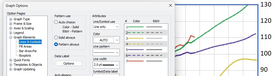

Postby tvonbrasch » Wed Feb 04, 2026 2:56 am
I’d like to report a possible bug related to line patterns in mixed-frequency graphs. When I plot a series in a mixed-frequency graph and set the line pattern to a “spaced/dashed” style (i.e., a line pattern with spaces), the rendered graph displays a solid line across the entire sample instead of the specified pattern.
This seems to occur specifically in a mixed-frequency graph; my suspicion is that the line-style setting is not being applied (or is being overridden) in the mixed-frequency rendering routine. I’ve attached (1) the EViews graph object/output and (2) the code used to generate the graph so you can reproduce the issue. Could you please investigate and fix this issue?
Version: EViews 14 jan5 2026
Program:
'''''''''''''''''''''''''''''''''''''''''''''''''''''''''''''''''''''''''''''''''''''''''''''''''''''''''''''''''''''''''''''''''''''''''''''''''''''''''''''''''''''''''''''''''''''''''''''''''''''''''''''''''''''''''''''''''''''''''''''''''''''''''''''''''''''''''''''''''' ' Dette programmet plotter boliginvesteringer og realboligpriser. Først spesifiserers ' navn på grafen, overskrift, underoverskrift og kildehenvisning. Språk og nummerering ' avhenger av hvorvidt figuren skal i KT eller ES eller på Powerpoint slides (i bredt format). ' Fastprisåret defineres i masterfilen. Formatering av skriften skjer lenger ned i programmet. ' '''''''''''''''''''''''''''''''''''''''''''''''''''''''''''''''''''''''''''''''''''''''''''''''''''''''''''''''''''''''''''''''''''''''''''''''''''''''''''''''''''''''''''''''''''''''''''''''''''''''''''''''''''''''''''''''''''''''''''''''''''''''''''''''''''''''''''''''''' 'Programargumentet velger norsk eller engelsk figurtekst, med eller uten figurnummerering !count = !count +1 ' increase figure number %nr = @str(!count) ' make the number into a string if %spraak = "Norsk" then %gr = "boligmarkedet" 'displaynavnet i spoolobjektet %underoverskrift1 = "Sesongjustert, indeks, " + %fastprisaar + " = 100" %kilde = "Kilde: Statistisk sentralbyrå" 'Spesifiserer navnet (legend) for de inkluderte seriene. %serie1 = "Nominelle bruktboligpriser " %serie2 = "Reelle bruktboligpriser " %serie3 = "Boliginvesteringer" %serie4 = "Nominelle nyboligpriser" if %figur = "KT" then %hovedoverskrift = "Figur 2."+%nr+". Boligmarkedet" else '%figur = "Powerpoint", dermed intet figurnummer %hovedoverskrift = "Boligmarkedet" %underoverskrift1 = "Sesongjustert. Indeks, " + %fastprisaar + " = 100" ' Høyre akse: mrd "+ %fastprisaar + "-kr, kvartal og måned" endif else '%spraak = "Engelsk" %gr = "housing_market" %underoverskrift1 = "Seasonally adjusted, index, " + %fastprisaar + " = 100" %kilde = "Source: Statistics Norway" %serie1 = "Nominal 2nd-hand housing prices" %serie2 = "Real 2nd-hand housing prices" %serie3 = "Housing investment" %serie4 = "Nom. new home prices" if %figur = "KT" then %hovedoverskrift = "Figure "+%nr+". Housing market" else '%figur = "Powerpoint", dermed intet figurnummer %hovedoverskrift = "Housing market" endif endif if @isobject(%gr) = 1 then delete {%gr} endif 'Kan fastsette range på aksene. Hvis ikke noe er spesifisert genereres det automatisk. %leftaxisrange = "58,130" %rightaxisrange = "58,130" ' Kopierer serier og ager glatt prediksjonsserier ved hjelp av addin-programmet kvarts_sa 'wfselect {%data_workfile} ' gjør til aktiv workfile pageselect q smpl @all kvarts_sa(level) pbol pbol_gg ' nominell boligpris 'kvarts_sa(level) jks83 jks83_gg ' boliginvesteringer copy kvarts\pbol_sa_h_real pbol_real_sa copy kvarts\pbol_sa_h_real kvarts\pbol_real ' for linje 80 i addin programmet kvarts_sa kvarts_sa(level) pbol_real pbol_real_gg ' realboligpris ' Beregning av boliginvesteringer som indeks ps m smpl @all kvarts_sa jks83 genr jks83_h = jks83_sa*3/1000000 smpl {%fastprisaar}m1 {%fastprisaar}m12 !aarsgjennomsnitt = @mean(jks83_h) smpl !startyear 2016q1 genr jks83_h = q\jks83_sa smpl @all genr jks83_hh = 100*jks83_h/!aarsgjennomsnitt %sisteobs = jks83.@last ' siste måned med observasjon/verdi smpl {%sisteobs} !endyear ' @now-3 !endyear genr jks83_gg = jks83_sa_kt*3/1000000 jks83_gg = 100*jks83_gg/!aarsgjennomsnitt ps q smpl {%fastprisaar}q1 {%fastprisaar}q4 !aarsgjennomsnitt = @mean(pbol_sa) !aarsgjennomsnitt_ny = @mean(pbol_ny) 'Lager grafen wfselect {%data_workfile} ' gjør til aktiv workfile pageselect kvarts smpl !startyear !endyear graph {%gr}.line(x) q\pbol_sa*100/!aarsgjennomsnitt q\pbol_gg*100/!aarsgjennomsnitt m\jks83_hh m\jks83_gg q\pbol_real_sa*100 q\pbol_real_gg*100 q\pbol_ny*100/!aarsgjennomsnitt_ny 'Setter størrelsen på grafen {%gr}.options linepat size({!width}, {!height}) 'Formaterer akser og støttelinjer {%gr}.options frameaxes(lbrt) framewidth(0.5) gridwidth(0.5) gridcolor(ltgray) ' gridl(7) gridr(7) 'Formaterer aksene {%gr}.axis(l) range({%leftaxisrange}) font(Open Sans,13,-b,-i,-u,-s) {%gr}.axis(r) range({%rightaxisrange}) font(Open Sans,13,-b,-i,-u,-s) ticksnone {%gr}.axis(b) units(n) font(Open Sans,13,-b,-i,-u,-s) {%gr}.options -gridr gridcust(year, 1) {%gr}.datelabel interval(year, 2, {!endyear}) span(between) ' 'Formaterer seriene. Note: hvis det lages en graf med to akser ( line(x) ) så vil første serie måles på venstre akse og alle andre på høyre akse hvis ikke annet spesifiseres. {%gr}.setelem(1) linecolor(@rgb({%gronn3})) legend(%serie1) axis(l) linewidth(!linewidth) {%gr}.setelem(2) linecolor(@rgb({%gronn3})) linepattern({%dashline}) legend() axis(l) linewidth(!linewidth) {%gr}.setelem(3) linecolor(@rgb({%gul3})) linepattern(solid) legend(%serie3) axis(r) linewidth(!linewidth) {%gr}.setelem(4) linecolor(@rgb({%gul3})) linepattern({%dashline}) legend() axis(r) linewidth(!linewidth) {%gr}.setelem(5) linecolor(@rgb({%lilla5})) linepattern(solid) legend(%serie2) axis(l) linewidth(!linewidth) {%gr}.setelem(6) linecolor(@rgb({%lilla5})) linepattern({%dashline}) legend() axis(l) linewidth(!linewidth) {%gr}.setelem(7) linecolor(@rgb({%oransj4})) linepattern(solid) legend(%serie4) axis(r) linewidth(!linewidth) 'legger til overskrift, underoverskrifter, kilde og legend if %figur = "KT" then {%gr}.addtext(-0.4, -0.7, textcolor(@rgb(0,0,0)), fillcolor(@rgb(255,255,255)), framecolor(@rgb(0,0,0)), just(l) , font(Open Sans Semibold,16,b,-i,-u,-s)) %hovedoverskrift {%gr}.addtext(-0.4, -0.4, textcolor(@rgb(0,0,0)), fillcolor(@rgb(255,255,255)), framecolor(@rgb(0,0,0)), just(l) , font(Open Sans,14,-b,-i,-u,-s)) %underoverskrift1 {%gr}.addtext(-0.4, 4.1, extcolor(@rgb(0,0,0)), fillcolor(@rgb(255,255,255)), framecolor(@rgb(0,0,0)), just(l) , font(Open Sans,12,-b,-i,-u,-s)) %kilde {%gr}.legend columns(2) -inbox position(0, 3.4) font(Open Sans,14,-b,-i,-u,-s) else '%figur = "Powerpoint {%gr}.addtext(-0.4, -0.9, textcolor(@rgb(0,0,0)), fillcolor(@rgb(255,255,255)), framecolor(@rgb(0,0,0)), just(l) , font(Open Sans Semibold,20,b,-i,-u,-s)) %hovedoverskrift {%gr}.addtext(-0.4, -0.5, textcolor(@rgb(0,0,0)), fillcolor(@rgb(255,255,255)), framecolor(@rgb(0,0,0)), just(l) , font(Open Sans,14,-b,-i,-u,-s)) %underoverskrift1 {%gr}.addtext(-0.4, 4.9, textcolor(@rgb(0,0,0)), fillcolor(@rgb(255,255,255)), framecolor(@rgb(0,0,0)), just(l) , font(Open Sans,12,-b,-i,-u,-s)) %kilde {%gr}.legend columns(3) -inbox position(0, 4.4) font(Open Sans,14,-b,-i,-u,-s) endif ' Legger objektet til i spoolen copy {%gr} kvarts\{%gr} pageselect kvarts graphs.append(name={%gr}) {%gr} ' Spar figuren med spesielt navn i spesiell mappe for default aksess fro layoutdamene %sti_og_filnavn = %SharePoint_sti_pdf + %nr {%gr}.save(t=pdf, c, box, port, w=5.5, h = 3, u=in, d=300, trans) {%sti_og_filnavn} %sti_og_filnavn = %SharePoint_sti_png + %nr {%gr}.save(t=png, d=800) {%sti_og_filnavn} ' får ikke med stiplinger i EViews 14 ' Hvis figur er til Powerpoint slides lagres den på disk if %figur = "Powerpoint" then %mappe = @runpath {%gr}.save(t=jpg,d=800) {%mappe}\Figurer_til_Powerpoint_slides\{%gr} endif
graph.wf1
(32.75 KiB) Downloaded 1928 times

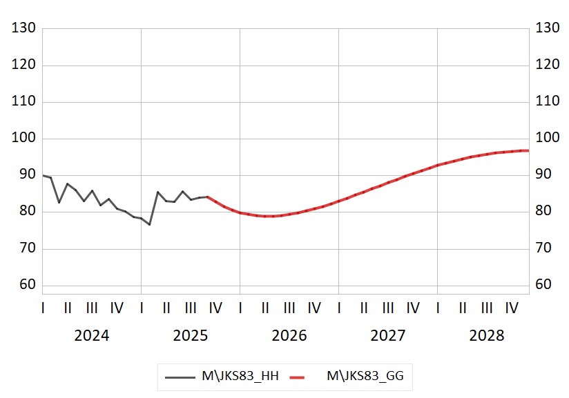

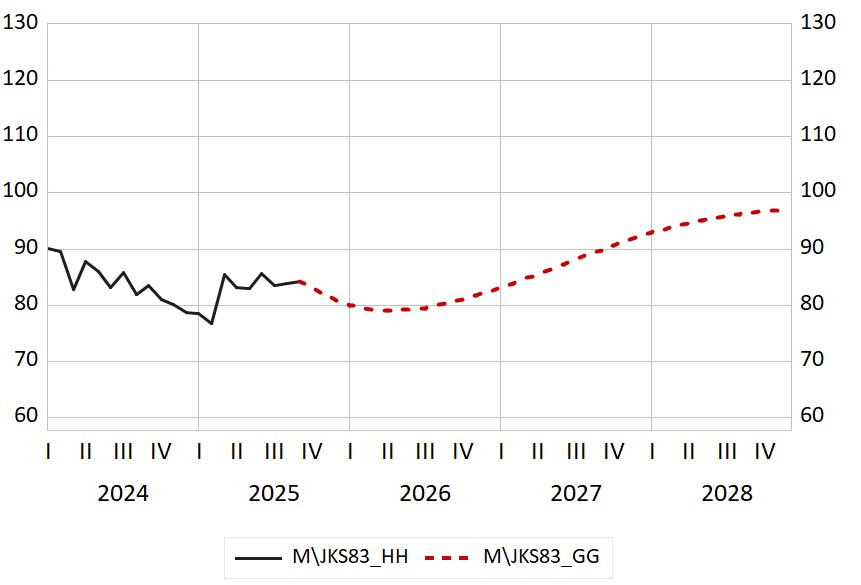

Thanks for the reply. I still suspect this is a bug, so I have created a workfile to help you reproduce the issue.
The graph below was generated using the code provided, running in EViews 12:
However, running the same code in EViews 14 produces this result:
Could you please take a look?
close @all wfopen .\graphbug pageselect q %gr="_gr" !width = 5.5 !height = 3 %leftaxisrange = "58,130" %rightaxisrange = "58,130" smpl 2024 2028 graph {%gr}.line(x) m\jks83_hh m\jks83_gg {%gr}.options frameaxes(lbrt) framewidth(0.5) gridwidth(0.5) gridcolor(ltgray) {%gr}.axis(l) range({%leftaxisrange}) font(Open Sans,13,-b,-i,-u,-s) {%gr}.axis(r) range({%rightaxisrange}) font(Open Sans,13,-b,-i,-u,-s) ticksnone {%gr}.setelem(2) linepattern(dash6) axis(r) linewidth(2) {%gr}.options linepat size({!width}, {!height}) show {%gr}
graphbug.wf1
(28.25 KiB) Downloaded 362 times

Postby tvonbrasch » Fri Feb 06, 2026 5:25 am
The issue is still present, but I have noticed some strange behavior. If I make the graph object smaller in EViews, the dashed lines appear correctly. However, if I make the graph wider, the dashed lines disappear. Please take a look.
