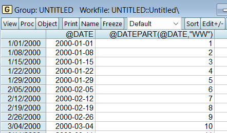

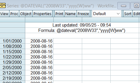

Well, the functions @dateval and @datepart(@date, week) obviously assign 1) a date to a specified week and 2) a week to a specified date, respectively. So there seems to be a uniquely defined link between weeks and dates (as is also the case with months and dates).
So suggestion here. Please make @makedate work also applicable to weeks in future updates of Eviews.
wfcreate w 2000 2010 show @dateval("2008W33", "yyyy[W]ww") show @date @datepart(@date, "WW")

Those two functions are series functions, and so are able to use workfile context to determine the dates that correspond to the weeks (and vice versa). If you create a monthly workfile instead of a weekly workfile, you'll notice that @dateval fails.
@makedate is not a series function and so does not use workfile context.
