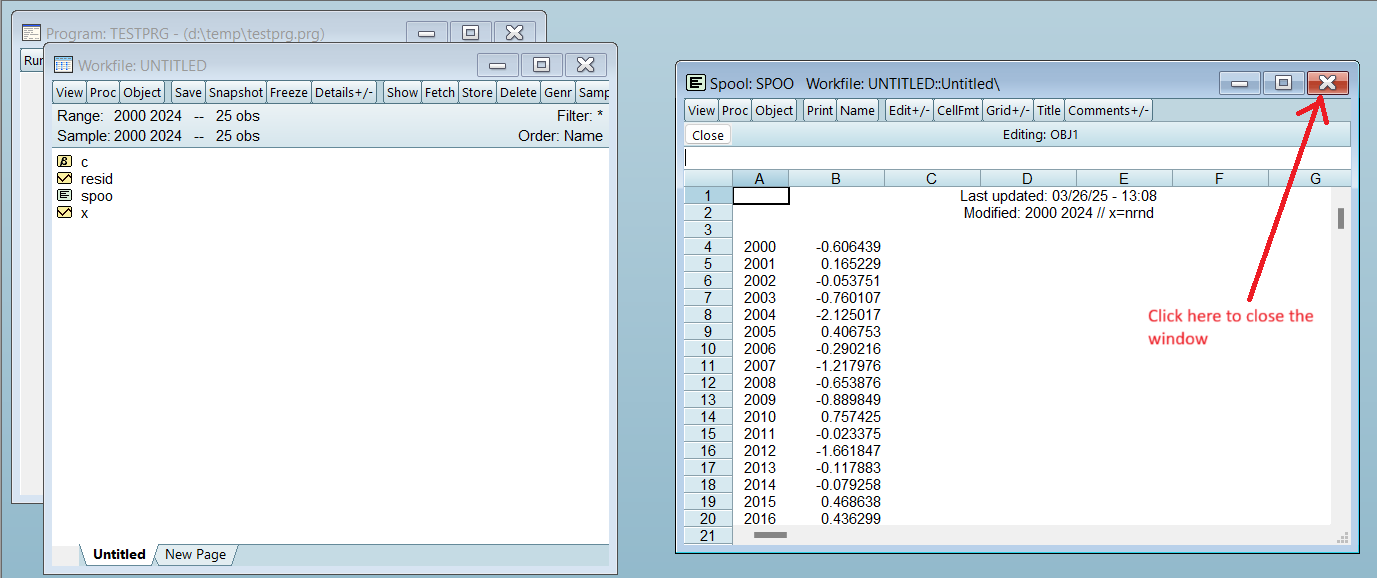

In order to replicate the bug, you may run the program below. Then, 1 click on "obj1"within the spool and thereafter 2 close the window as indicated in the screenshot and 3 click on the spool labelled "spoo" in the Eviews page to re-open it. Eviews would crash immediately after the last step.
