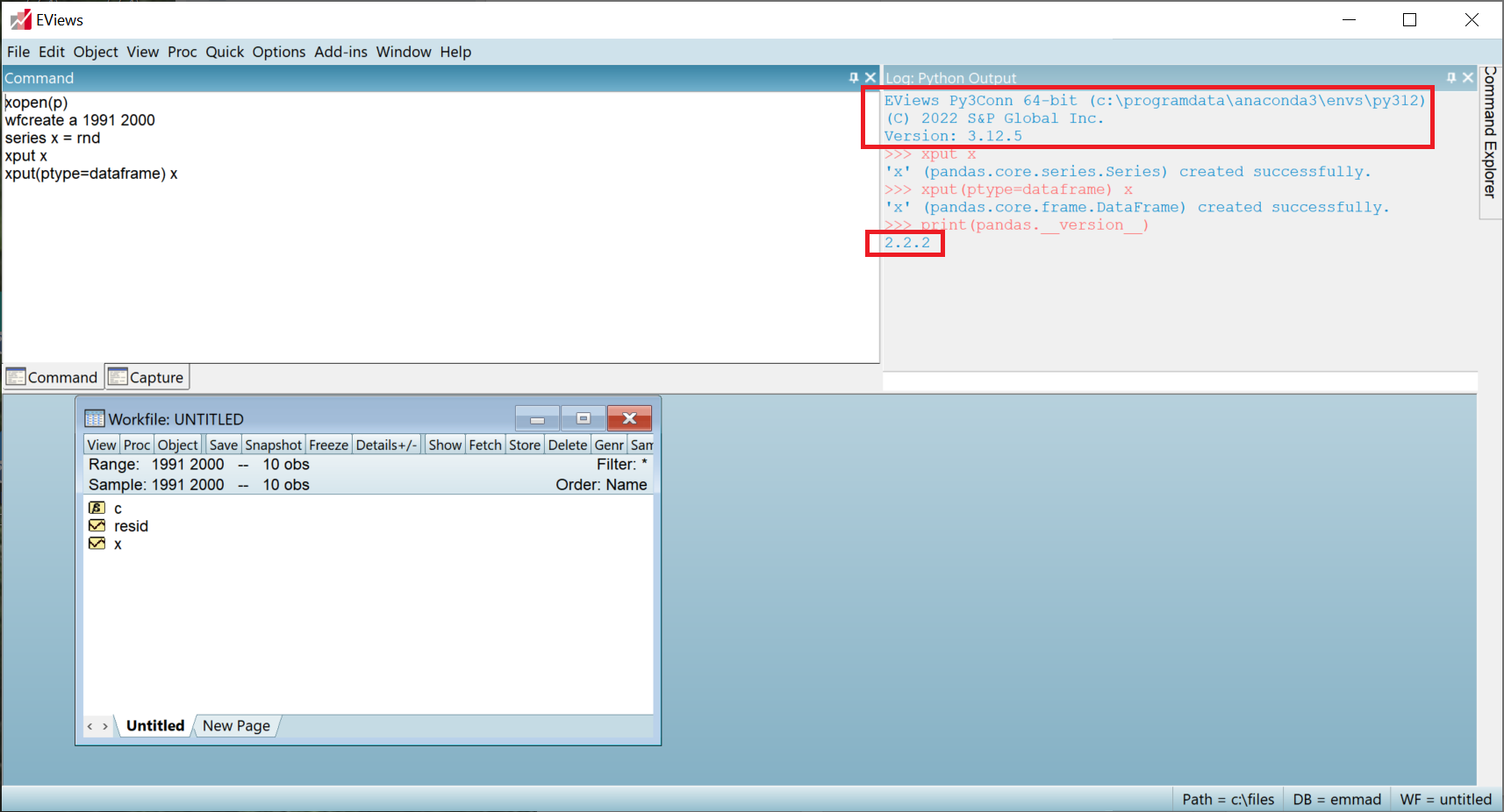

Postby EViews Steve » Tue Sep 03, 2024 8:03 am
Krille:
I just tried XOPEN(P) from within EViews 13 using pandas 2.2.2 and it worked just fine.
Are you using a recent version of EViews 13? I'm running the Aug 28, 2024 build.

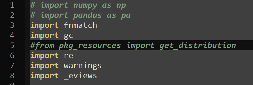

Postby EViews Steve » Tue Sep 24, 2024 9:24 am
Ok, found the problem.
Our "_eviewsPandas.py" has an unused reference to a package that is no longer available starting with Pandas 2.2. Since our code doesn't actually use that package, we can just comment it out.
I'll fix this in the next patch, but for now, if you want the fix earlier, edit the "_eviewsPandas.py" file located in the EViews directory and comment out line 5 by placing a hashtag '#' in front, like this:
After making that change, you should be able to call XOPEN(p) with pandas 2.2 installed.
