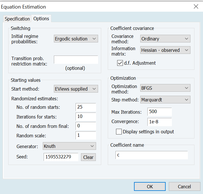

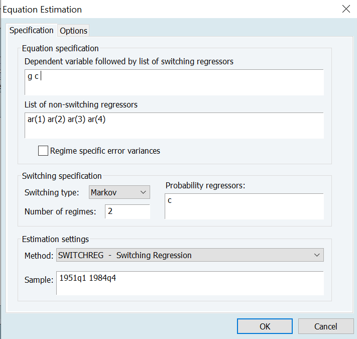

by KlimisStilp
Thanks for your reply.
I used 1e-8 as a tolerance convergence.
Also, you can see the settings in the photos attached.
Maybe it is something that I overlooked since I am a beginner at Eviews.
If so please feel free to inform me.
Best regards

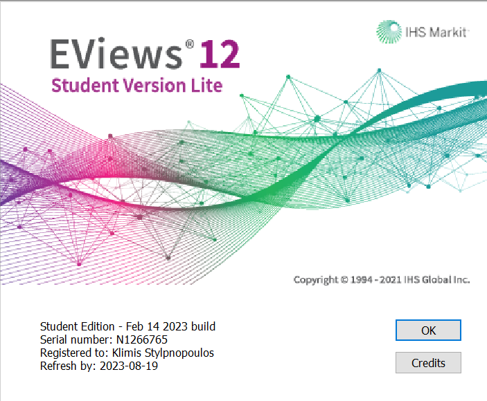

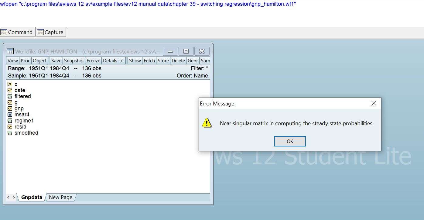

Thanks. That's useful, but I still can't replicate. Could you send me a screenshot of your output. And can you take a look at the Help/About EViews main menu item and give me information about your version and build-date. Thanks.
Re: Near singular matrix in computing the steady state probabilities.
Posted: Wed Aug 09, 2023 10:56 am
by KlimisStilp
The output that I get is:
And the version etc. is:

Still looking into this. The problem is that while I do see the error in the Student Lite version, it does not appear in the standard EViews 12, nor in any of our standard tests. Will continue to explore. Thanks for you patience.
Posted: Wed Aug 16, 2023 3:52 pm
by EViews Glenn
Hi. Found the issue. It's EVIews 12 only. A patch has been posted. You can initiate by selecting Help/EViews Update... from the main EViews menu.
