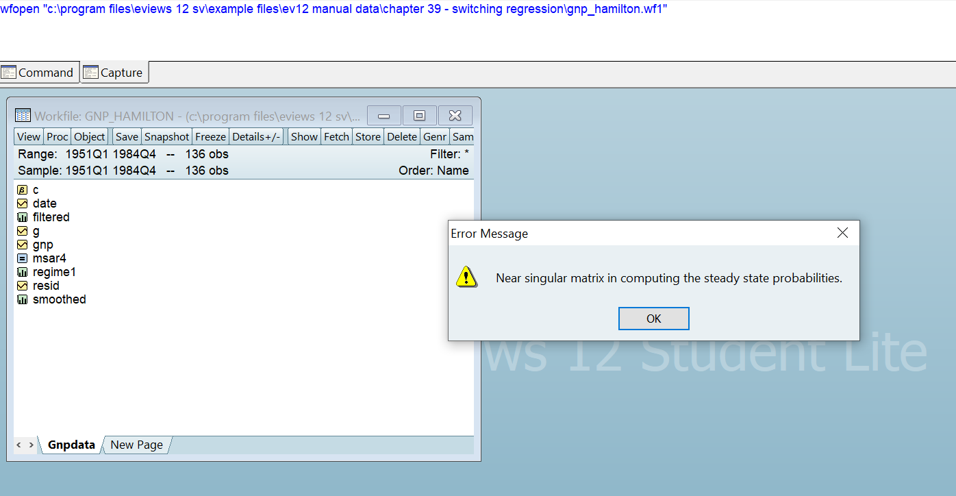

I get the error message: "Near singular matrix in computing the steady state probabilities." when I try the example regarding Hamiltons GNP, using reviews workfile attached:
gnp_hamilton.wf1
(49.12 KiB) Downloaded 3406 times
I followed all the steps from the manual and I keep receiving this error message.

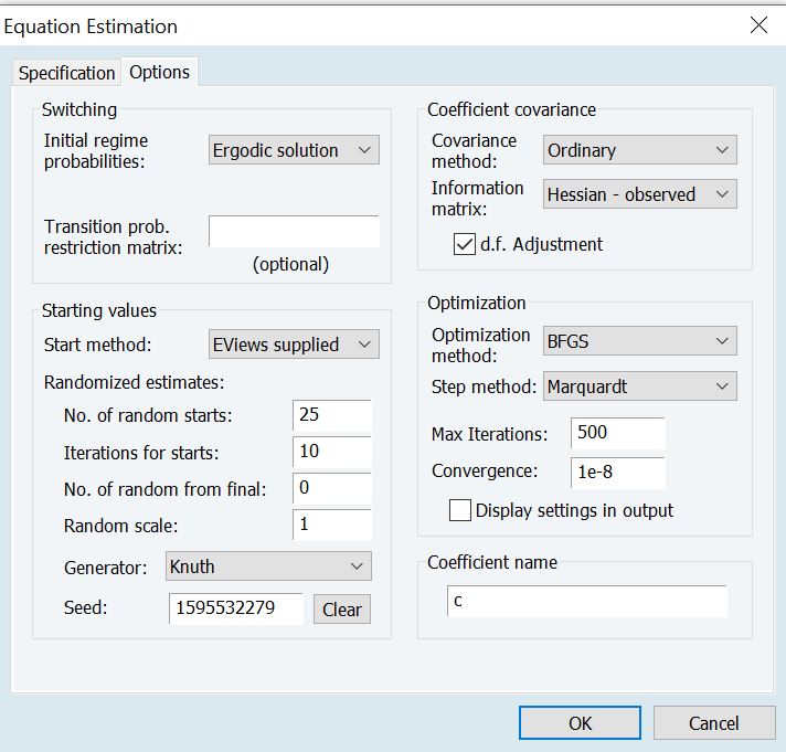

Hi. I've tested this on various versions of EViews (not Student Lite yet, but I will if we can't pin this down) and in all cases, it converges and produces standard errors. But before going further, I did want to ask you if you are using the seetings in that equation without change, and if so, what convergence tolerance you are using. Thanks.

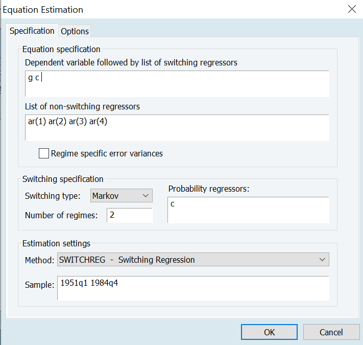

I used 1e-8 as a tolerance convergence.
Also, you can see the settings in the photos attached.
Maybe it is something that I overlooked since I am a beginner at Eviews.
If so please feel free to inform me.

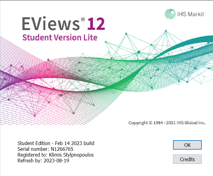

Thanks. That's useful, but I still can't replicate. Could you send me a screenshot of your output. And can you take a look at the Help/About EViews main menu item and give me information about your version and build-date. Thanks.

The output that I get is:
And the version etc. is:
