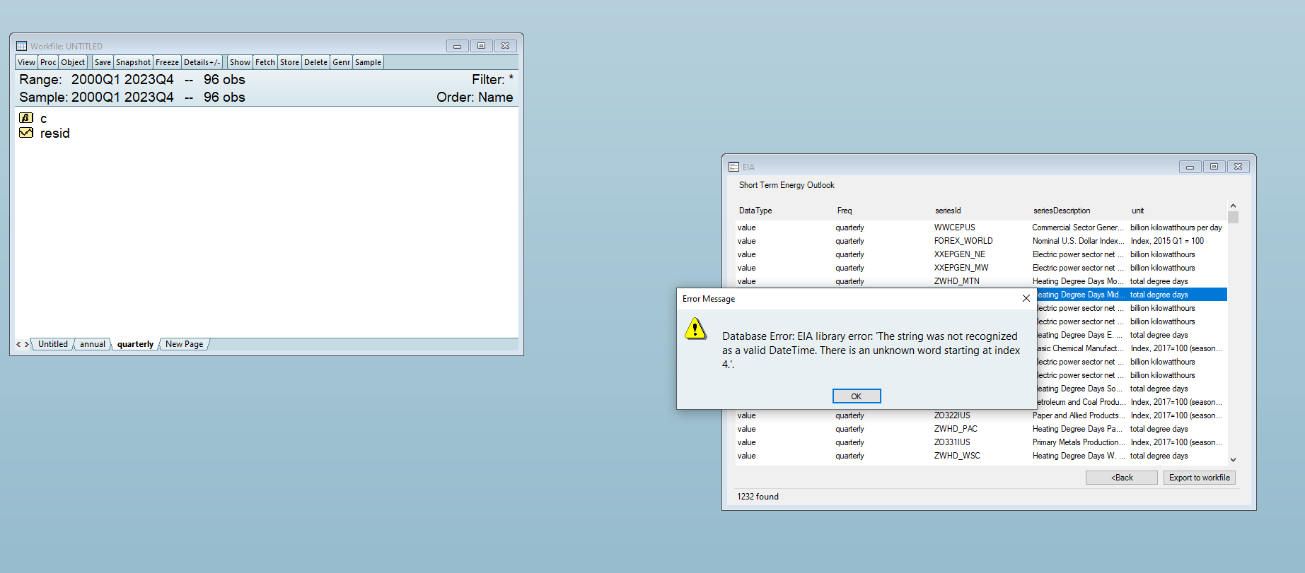

I tested the fix.
Monthly and annual frequency requests seem to work.
Quarterly requests fail with the error pictured in the attachement.
But I can work around those.
Thanks again.

Postby EViews Steve » Tue May 02, 2023 7:46 am
Quarterly problem has been fixed and will be available in next 13 patch.
