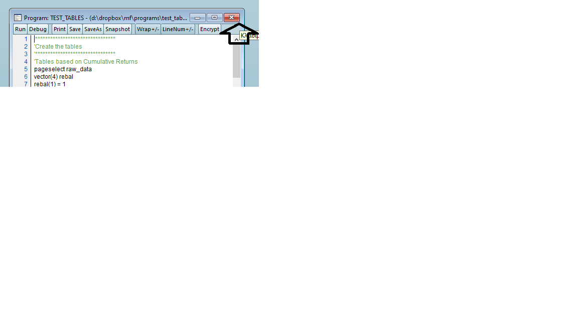

Eviews crashes when I close a program window and press the X button at a point the image shows
Kind Regards,
[attachment=0]eviews.png[/attachment]
I use the Enterprise edition Nov 28 2022 build

I tried to replicate this using EViews 13 and couldn't. Does the crash occur when you simply open the program and then close it using the red X button? Or do you have to run it first?
And do you have the Pane & Tab mode turned off? (Options menu/General Options/Environment/Appearance/Window type/Use panes & tabs)
Does this crash occur with any other program or is it specific to this one?

I selected the Pane & Tab mode and the Eviews does not crash anymore.
The crash did not occur in any other program.
