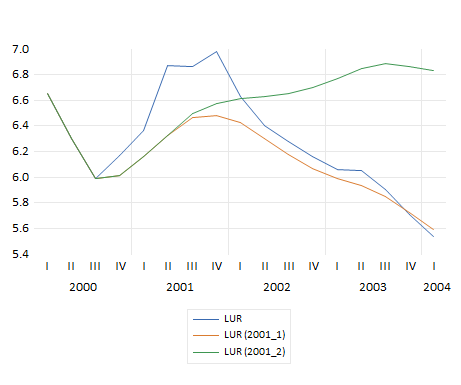

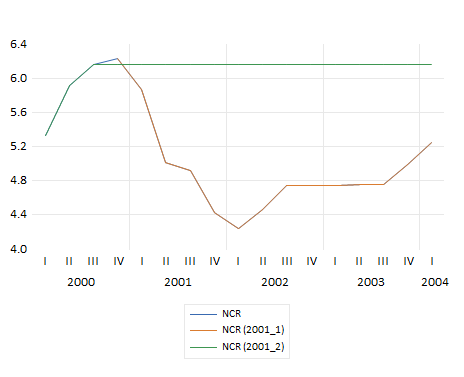

In my model I have one control/policy variable (NCR) and a dependant variable of interest (LUR). The historical choices are shown in blue, alongside two scenarios I have solved.
I simulate two scenarios with NCR overridden as an exogenous variable. The first scenario (2001_1) sets the NCR to be exactly the same as its historical series. But when I solve this scenario I find the outcomes LUR (2001_1) diverge from the historical outcomes. I assume this is because when the scenario is solved it assumes all shocks are set to zero? If I set the exogenous variable to exactly match it's historical series shouldn't the scenario solution be the same? Is there some option I can select so this is the case?

Furthermore when I run a Scenario in which the policy variable is fixed ata. constant level (2001_2), the scenario solution doesn't seem to take into residuals in 2001, but instead produces a smooth series.

It's possible that overriding a variable while still using its previously solved values could produce different results for other endogenous series. I believe this outcome could arise if (1) the overridden variable were part of a recursive block of variables in the model, and (2) the system of equations encompassed by that block were under-specified. Since condition (1) is common enough, the real culprit is condition (2), which implies that the solution to the model is not unique. Disrupting the way in which that block is calculated by overriding said variable could be enough to generate a different, but equally correct, solution.
This is all assuming there isn't some bug at work. Would you be able to share your workfile with us? You don't necessarily need to do so publicly here on the forum, you may also email us at support@eviews.com.
