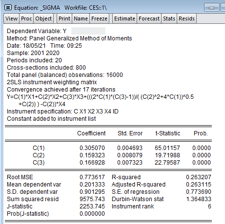

I am estimating an equation using GMM in a panel workfile:
equation eq.gmm y=exp(c(1))*x1+c(2)*x2+exp(c(3))*x3+(((2*exp(c(1))*(exp(c(3))-1))/( (c(2)^2+4*exp(c(1)))^0.5+c(2)) ) -c(2))*x4 @ x1 x2 x3 x4 ID

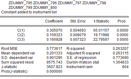

where ID is the cross-section identifier. If I alternatively create a dummy variable for each cross-section identifier and estimate the equation
equation eq.gmm y=exp(c(1))*x1+c(2)*x2+exp(c(3))*x3+(((2*exp(c(1))*(exp(c(3))-1))/( (c(2)^2+4*exp(c(1)))^0.5+c(2)) ) -c(2))*x4 @ x1 x2 x3 x4 dummy1 dummy2 ... dummyN
I get identical results (see pictures below). The advantage of using the first specification is that it is about 15 times faster than the second specification (maybe because of sparse matrix functionality ...).

Question 1: are the first two gmm equation specifications above equivalent?
Question 2: if yes, why does not EViews count the ID variable as multiple instruments, equal to the number of cross-sections?
