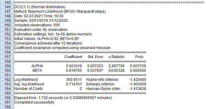

An example workile is attached. Simply, load the workfile (data_dcc_rgarch_example.wf1) and run the add-in.
You may run GUI or the command line.
The command line example:
dcc_rgarch(dep="aapl_rt amd_rt google_rt ibm_rt intel_rt", model="rgarch", dep_high="aapl_high amd_high google_high ibm_high intel_high", dep_low="aapl_low amd_low google_low ibm_low intel_low", smpl="02/01/2019 31/12/2020", show_out="yes")
This example estimates the DCC-RGARCH model for five time series representing stock data.
Notice, that the date representation is day/month/year, so it may need adjustments.
The output table for the DCC model should be like the following:
[img]
[/img]
