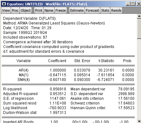

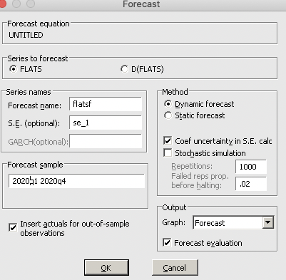

I start to work on a model and everything is fine. I open a file(.xls suffix), quarterly data,1998q1-2019q4, and then I open estimate equation and estimate the model SARIMA(1,0,1) (0,0,1) which consists of these parts: d(flats) sar(4) sma(4) ma(1) and estimation output is normal. Then thru "resize involves inserting 4 observation" create space for 4 quarters. But when I made forecast thru forecast-flatsf and I add se_1 in enter in the S.E. optional, and forecast sample is 2020q1 to 2020q4 and press ok, I don't see confidence interval in the picture, only a prediction for the exogenous variable. I don't have idea what is wrong. :/ :/ :-(

here is the file I work with and screenshots of estimation output, forecast prediction and forecast prediction graph. Strange thing is that when I open a file we received from university teacher for training, it works normally. I checked everything on my own file, suffix of file, name of file etc. but still the same result.
