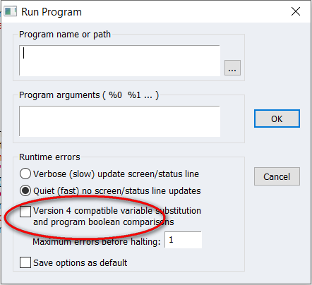

When you run the program do you have "Version 4 Compatible Mode" turn on?

version 4 compatibility is on

Postby EViews Gareth » Thu Sep 03, 2020 8:23 am
Turn it off.

Postby ottavio.ricchi » Thu Sep 03, 2020 8:28 am
Gosh,
you are right, thank you.
...stil,l if version 4 is on, it works with three quotation marks
