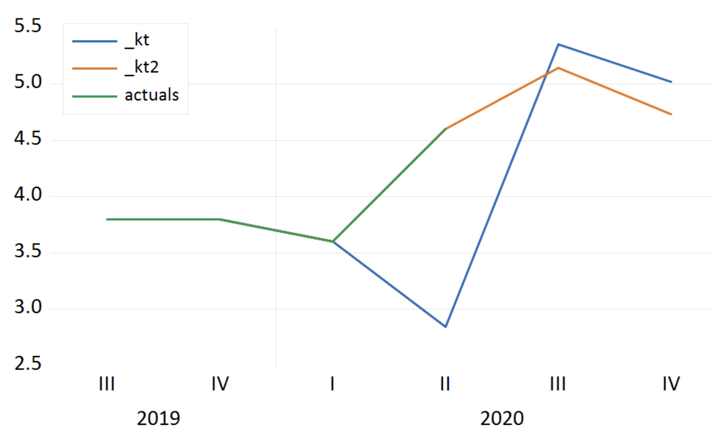

Thanks for your reply, Matt. It does not work with v=n. I am probably doing something wrong. Can you please take a look at the following code:
'set smpl smpl 2018 2025 'turn on actexist {%m}.exclude(actexist=t) {%excludes} 'solve model {%m}.solve 'copy solution copy *_kt *_kt2 'set residuals to match actives {%m}.addinit(v=a) @all '(it does not work with v=n) 'turn off actexist {%m}.exclude(actexist=f) {%excludes} 'solve the model again {%m}.solve 'compare solutions smpl 2019:3 2020 line ur_kt ur_kt2
This produces the following graph:
As you can see, the simulation does not reproduce the actuals-value in 2020:2.
Is there an obvious fix that I should do? If not, I can share the workfile with you on monday.

I believe the issue is a set of missing add factors for 10 variables named pcja??_a. Some series with that name pattern are add factors for variables named pcja??, but the 10 variables I speak of unfortunately are named like add factors and would have their own add factor series named pcja??_a_a. Simply reenabling add factors for all of the model's variable appears to fix the issue, e.g., inserting "{%m}.addassign @all" before the addinit statement.

In the model you sent me, the last 10 equations did not have add factor enabled. The odd add factor names worked fine for me, e.g., variable pcja00's add factor is named pcja00_a2 because pcja00_a is another variable in the model. I think the root issue was just that 10 variables were missing add factors, e.g., pcja00_a didn't have an add factor (to be named pcja00_a_a), which turned out to be necessary to match the trajectory you wanted.
