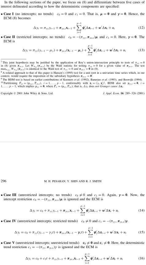

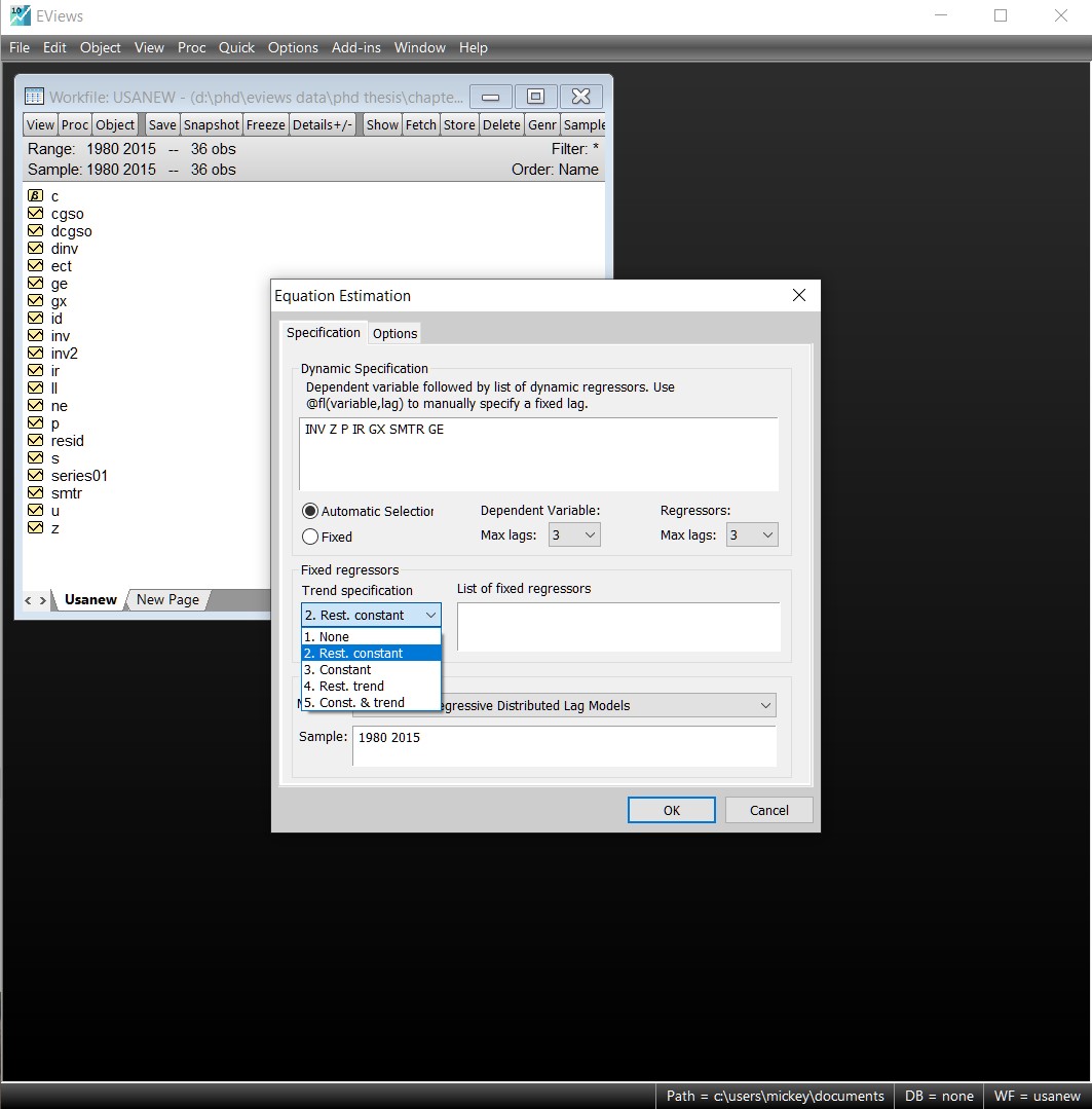

I am running my ARDL and ECM models and I am having some confusion surrounding Trend Specification and which option to choose (pictured).
Looking at guidelines from Eviews and other authors, option 2 and 3 seem to be the most popular.
I have read what each option means, however its difficult to understand why some choose option 2 when their data has a trend.
I have noticed that if you choose option 2, the ARDL model and the long run model (with coefficients) show a C (constant) term, however the ECM does not show a C (constant). With option 3, the ARDL and ECM model show the C (constant), however the long-run model shows no C (constant). Why is this the case?
With these confusions, which option should an author choose and why?

See Johansen cointegration procedure, 5 cases of deterministic terms specification. Here is pretty the same interpretation.

I really don’t like eviews for this. Literally all papers report a constant in both the long run as in the ecm. Are we really forced to combine both case 2 restricted constant to get a constant in the long run and case 3 unrestricted constant to get a constant in the ecm?

In the last 7 days, you seem to have been involved in more than 6 different EViews Forum threads related to ARDL questions. All are related or revolving around the same general idea. Most of the questions you've been asking have been answered by myself and/or Igor, or, you have been guided to the original papers and/or our ARDL blog series to seek the answers yourself.
Furthermore, the majority of your questions sound like homework exercises or are meant to delve into some discussion of what methodology is better, when to use a particular procedure, what can we conclude from this, and so on.
While there is certainly room in this forum for questions of your nature, be aware that you're not typically going to receive answers to such questions because the answers you seek are typically gained by reading many papers, gaining years of experience, and are just frankly next to impossible to answer most of the time. You will rarely receive an answer on this forum that says that one methodology is better than another, etc... because each has its own merits and each is used under the circumstances and assumptions that motivated their construction in the first place.
Finally, to get back to your last comment in this thread:
In another post you also wrote this:
Given that the long run relationship is not equal to the eviews levels equation this must be incorrect. However in Eviews there is no possibility to choose a case where AND a constant in the levels (long run) equation is given AND a constant in the EC-model, while most papers like for example the good author Narayan (2005), best in the field, does display both..
I'm sorry to be this blunt, but I have no idea what you're talking about! You keep mentioning some papers? You keep mentioning other resources that do something EViews doesn't. And that may very well be the case, but when it comes to the original ARDL paper by Pesaran, Shin, and Smith (2001), there are only 5 cases and not ONE of them involve a constant both inside and outside the error correction term.
You also seem to mention Narayan a lot. Well, either we're reading different papers or our level of comprehension is very different, but Narayan (2005) does NOT have a model where the constant is both inside and outside the error correction term. Here's Narayan's (2005) Appendix with finite sample critical values for the ARDL bounds test:
I guess what I'm trying to say is that you may not like what EViews does, but what EViews does is correct, and entirely in accordance with the important branches of literature.

What I was trying to say is the following, in attached picture: Narayan (2004) used the following tables. And while Michael also does similar research, we have based our finding (among many bad papers, of course) that the best to use paper (along to his supervisor with 20 years of econometric experience) that "Fiji's Tourism Demand: The ARDL Approach to Cointegration" was the best paper for ARDL to use.
When looking at the original PSS paper of 2001, I did not get wiser of the cases they propose and why. Igor gave a good explanation, however it is still not so clear for me. Every case is different.
Case 2 and case 3 gave exactly the same implication for the significance level of variables on short term (small difference, significance level stays the same) and long term (exactly the same) SO if I use 2 or 3 it does not matter a thing for my results. Most papers don't even discuss the constants.. so yeah, help me understand it better. It cannot be I am the only scholar that feels this way.

The comments to this post are very disappointing, as EnjoFaes and I have a strong point.
As shown by a very strong author, Narayan (2004), there is a reported Constant (C) for the long-run model and the ECM.
In fact, this is common in the literature.
An here lies the issue and hence the original question. We have read Pesaran, Shin, and Smith (2001) and understand the 5 cases, but confusion lies when so many authors report Constant (C) for the long-run and ECM. We wanted to ensure that if we follow Narayan (2004), we were able to include the (C) by using option 2 and 3 in the ARDL Eviews process.

Let's next turn to Narayan (2004), Tables 2 and 3 to be specific. Evidently, there is a constant inside and outside the cointegrating equation in the ECM. So what's going on?
Consider equation (2) above and notice that the only way we can actually have a constant both inside and outside the cointegrating equation in the ECM is if the determinstic dynamics mu(t) in the initial VAR model contain both a constant and a linear trend. In other words, mu(t) = mu0 + mu1*t. Hence, after differencing, mu1 is actually the term that contributes to the constant outside the cointegrating equation, and mu0 is the term that contributes to the constant inside the cointegrating equation.
Is this mentioned anywhere in Narayan (2004)? No, it's not!
