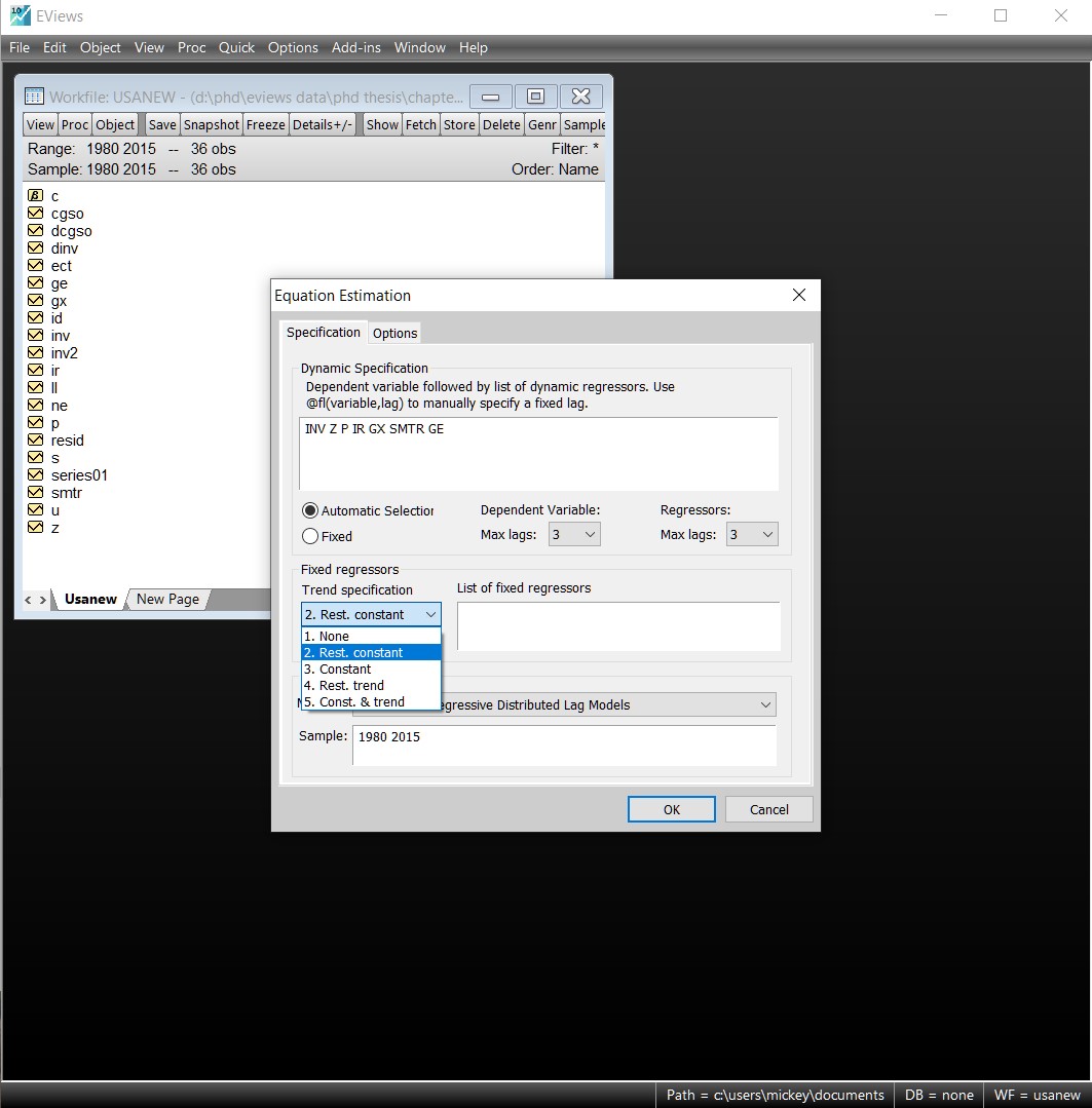

I am running my ARDL and ECM models and I am having some confusion surrounding Trend Specification and which option to choose (pictured).
Looking at guidelines from Eviews and other authors, option 2 and 3 seem to be the most popular.
I have read what each option means, however its difficult to understand why some choose option 2 when their data has a trend.
I have noticed that if you choose option 2, the ARDL model and the long run model (with coefficients) show a C (constant) term, however the ECM does not show a C (constant). With option 3, the ARDL and ECM model show the C (constant), however the long-run model shows no C (constant). Why is this the case?
With these confusions, which option should an author choose and why?

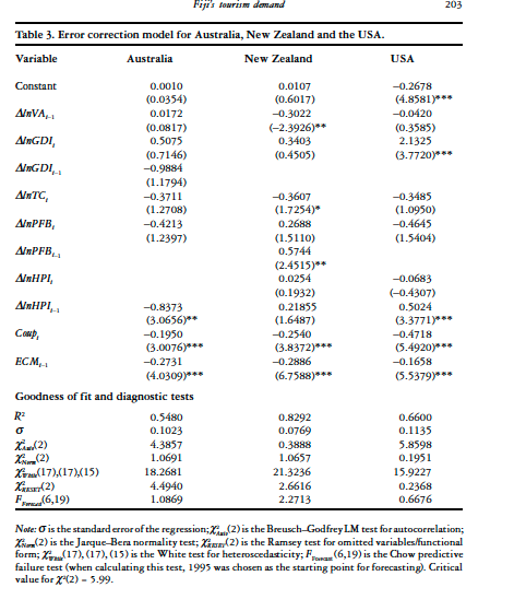

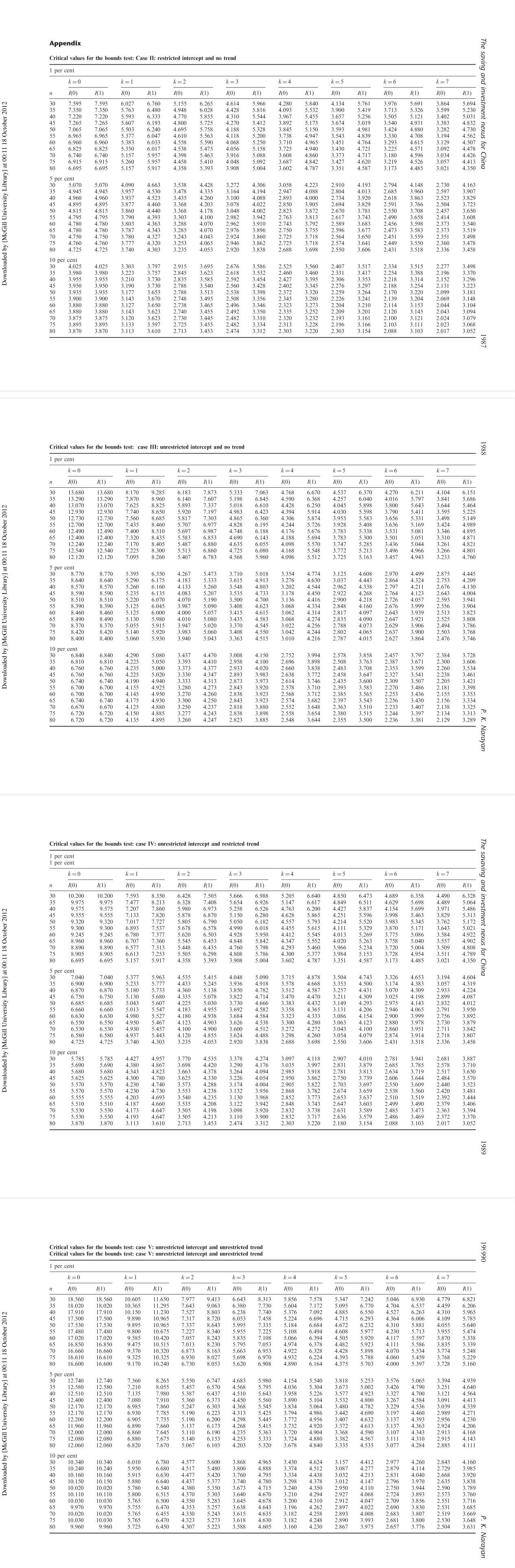

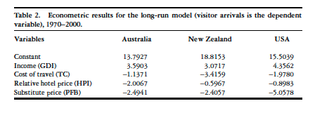

What I was trying to say is the following, in attached picture: Narayan (2004) used the following tables. And while Michael also does similar research, we have based our finding (among many bad papers, of course) that the best to use paper (along to his supervisor with 20 years of econometric experience) that "Fiji's Tourism Demand: The ARDL Approach to Cointegration" was the best paper for ARDL to use.
When looking at the original PSS paper of 2001, I did not get wiser of the cases they propose and why. Igor gave a good explanation, however it is still not so clear for me. Every case is different.
Case 2 and case 3 gave exactly the same implication for the significance level of variables on short term (small difference, significance level stays the same) and long term (exactly the same) SO if I use 2 or 3 it does not matter a thing for my results. Most papers don't even discuss the constants.. so yeah, help me understand it better. It cannot be I am the only scholar that feels this way.

Let's next turn to Narayan (2004), Tables 2 and 3 to be specific. Evidently, there is a constant inside and outside the cointegrating equation in the ECM. So what's going on?
Consider equation (2) above and notice that the only way we can actually have a constant both inside and outside the cointegrating equation in the ECM is if the determinstic dynamics mu(t) in the initial VAR model contain both a constant and a linear trend. In other words, mu(t) = mu0 + mu1*t. Hence, after differencing, mu1 is actually the term that contributes to the constant outside the cointegrating equation, and mu0 is the term that contributes to the constant inside the cointegrating equation.
Is this mentioned anywhere in Narayan (2004)? No, it's not!
Next, observe that equation (2) can in fact be written to look very similar to Case 4, as follows:

where b0 and b1 are some transformation of a0 and a1 in (2*)
This is in fact the starting point for analyzing the 5 cases presented in PSS(2001), although the same 5 cases can be observed in the work of Johansen. It's important to point out that what follows has also been thoroughly outlined in our blog series on ARDL models.
We now have the following assumptions:
Case 1: (No constant and no trend) => Assumption is a0=0 and a1=0
Case 2: (Restricted constant and no trend) => Assumption is a0=PI*mu0 and a1=0
Case 3: (Unrestricted constant and no trend) = > Assumption is a0\=0 and a1=0
Case 4: (Unrestricted constant and restricted trend) => Assumption is a0\=0 and a1=-PI*mu1
Case 5: (Unrestricted constant and trend) => Assumption is a0\=0 and a1\=0
Notice that whenever we have "restricted" deterministics, what's implied is that those deterministic terms are put inside the cointegrating equation.
(4) D(Y(t)) = (I - GAMMA(1) - ... - GAMMA(p-1) + PI)*mu1 - PI*mu0 + PI*(Y(t-1) - mu1*t) + GAMMA(1)*D(Y(t-1) + ... + GAMMA(p-1)*D(Y(t-p+1)
or
(4) D(Y(t)) = a0 + PI*(Y(t-1) - mu1*t) + GAMMA(1)*D(Y(t-1) + ... + GAMMA(p-1)*D(Y(t-p+1)
This is in fact Case 4 with the added restriction that a0 must satisfy restriction (r1) above. However, from the perspective of estimation, we can in fact estimate Case 4, obtain estimates of a0, PI, mu1, and GAMMA(k) for k = 1 to p-1 -- say hat(a0), hat(PI), hat(mu1), and hat(GAMMA(k)) respectively -- and then manually impose (r1) and back out the part of hat(a0) which is the constant outside and inside, namely:
const outside EC term: (I - hat(GAMMA(1)) - ... - hat(GAMMA(p-1)) + hat(PI))*hat(mu1)
const inside EC term: hat(a0) - ((I - hat(GAMMA(1)) - ... - hat(GAMMA(p-1)) + hat(PI))*hat(mu1))
Well that takes care of the constant term inside and outside, but we still have the trend term mu1*t inside the cointegrating equation which is not present in Narayan (2004). This is where the real confusion begins.
