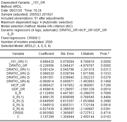

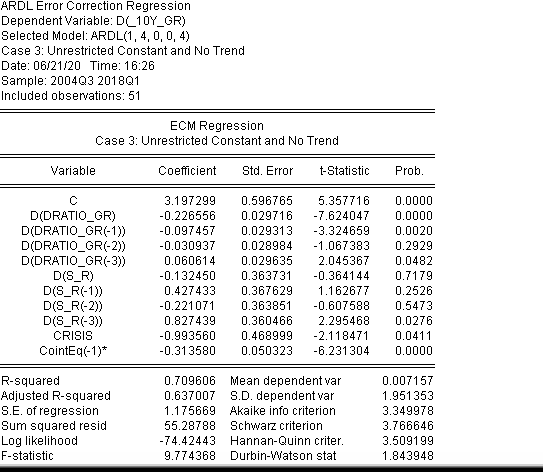

I attached both the ARDL model and the Error correction form Eviews shows me.

Which variables do you believe are missing?

In the ECM, HICP and GDP are missing

They are not dynamic (zero lags were selected)
